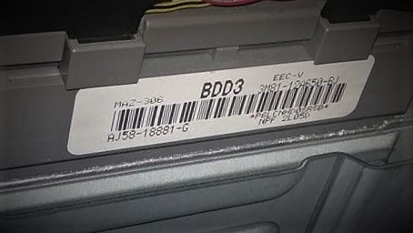

I started heating different sections of the car Fuse relays under hood, throttle body, fuse relays under the dash, and the PCM. It seems like after heating the pcm the car starts. So i figured i need to look into replacing it, but when i run the part number it comes up as an ecm, i thought they were different.
I have not had much luck finding a replacement and i have read that you need to get the exact match for your cars options.

PCM/ECU/ECM all the same thing, just different names.
I'm guessing you have a V6?
P2107 : Internal problems with PCM - Requires replacing
P2110 : NOT in my market
P2100 : NOT in my market

Thanks for the reply, I had taken the car to the dealership to have them replace the plugs, and we did have a bad coil at the beginning of the last year. Do you know a good place to look for a new ecm? I wasnt having much luck looking online.
