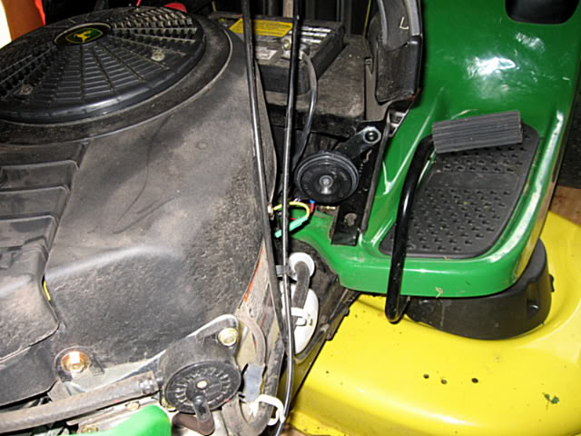

I put the set on my wife's Vibe which had the current REAL whimpy Toyota horn on it.
That horn now resides on my lawn tractor.....

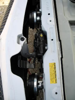

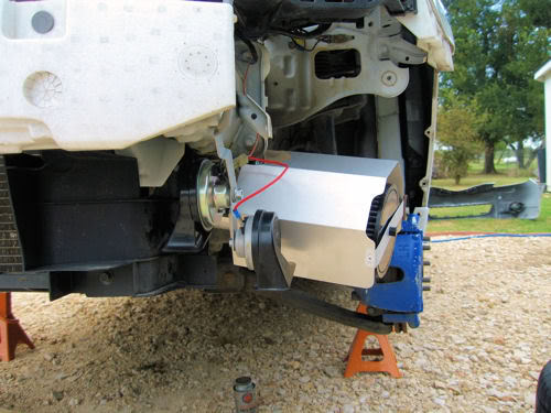

Removing the bumper cover will make the whole job just a little easier to deal with and really only takes 10 minutes or so. As to the job being technical it really isn't that bad. Pictured below is the little Y-connecter you need to make to split the power lead, and otherwise it's just a few bolts and screws. Still if you're not comfortable I'm sure you can find a college student somewhere willing to work for beer. If we lived closer I'd do it for you.
Actually I'll likely be doing my father's today.Thanks for the pics Richard, I was posting from a phone so picture links were a bit of a PITA. Here's a couple more blown up ones.
Here you can see the ground wire for the second horn connected to the bracket bolt. If you're using the stock horn then it doesn't have a ground connector, if you replace with another one then you'd just do this with both wires. My Freeway Blasters came with a ground wire for each horn.
