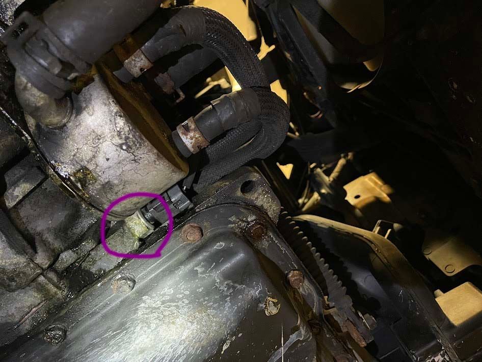

I have a 2010 Mazda 5, and there’s a bad leak above the oil pan, next to the transmission cooler. What is this part? It looks like the coolant temperature sensor, but the Mazda 5 has the coolant temperature sensor in a different location, not next to the transmission cooler.

Its not a transmission "COOLER" but a transmission fluid heater!
