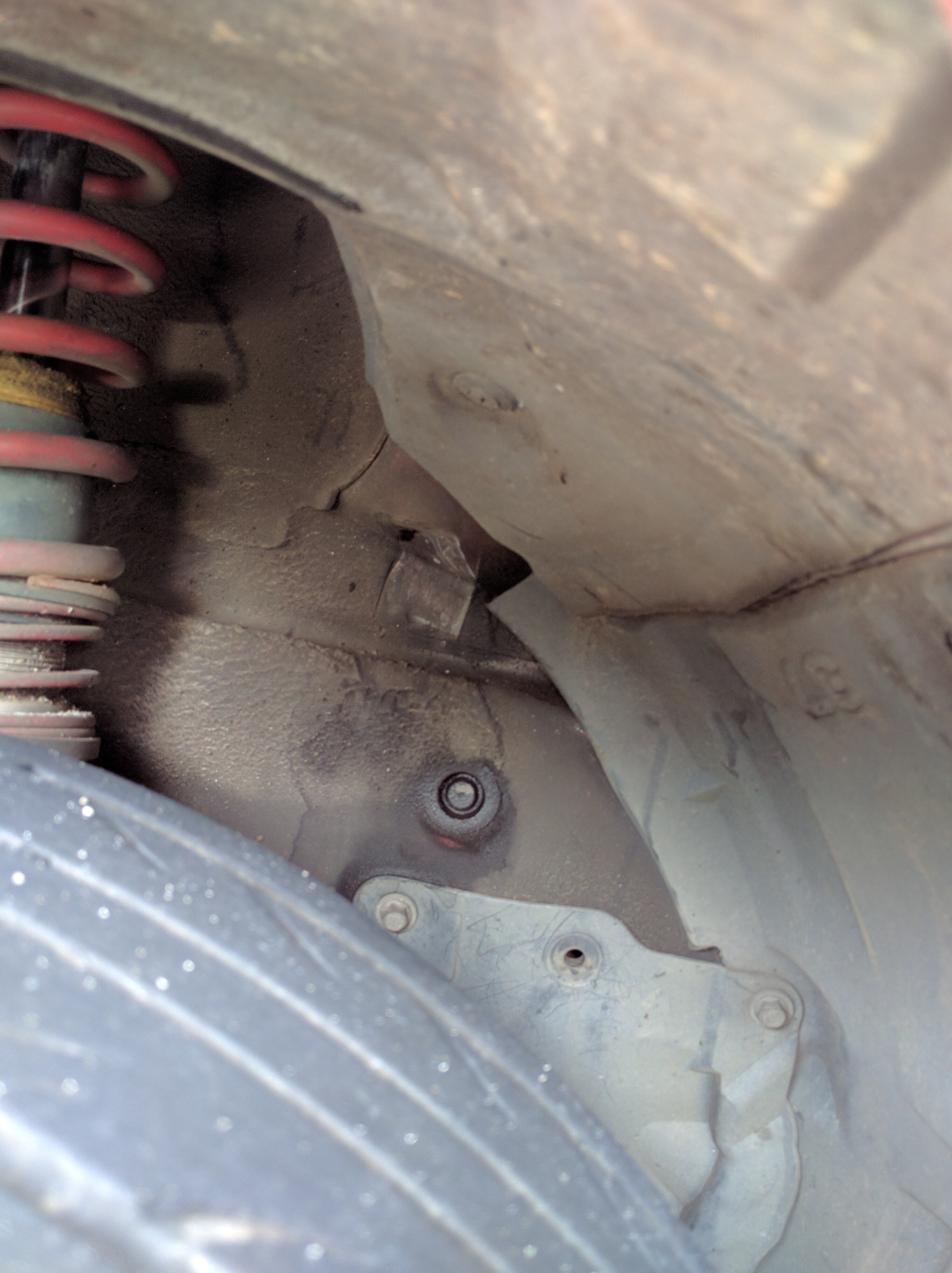

So here's my best shot at figuring it out. In the reservoir there's a little drain if the coolant level tops out. Pictures attached of where I found coolant.
What would cause the coolant to go that high in the reservoir....or even boil over? Looking to diagnose and fix this in the next couple days, but I'm not quite sure how to fix that. Doesn't seem like a sticky thermostat would cause this, or some bad seal....
Just now digging into the service manual, will update with findings. Thanks for any tips or help.
Sorry for the unhelpful potato pics, just trying to show exactly where the coolant dripped. Just looks like it dripped out the little hole on the bottom of the reservoir.

Top it up, go for a good drive to get it nice & hot, turn off the engine, carefully remove the reservoir cap, attach a pressure tester, pump it up to 20psi and start looking for signs of leakage.

Thanks for the tip. Don't have a pressure tester on hand but that's a good next step.
No new info except that everything above without the pressure test (topped off, bleeding cycles, all good) and parked it, just to watch it the coolant level rise and overflow again. Drained out the reservoir.
Took a pic of the reservoir but I don't think I can post it while mobile--definitely oil in the coolant reservoir. The odd thing is that the oil is clean, just dumped it all back into the engine. No coolant in the engine oil.
