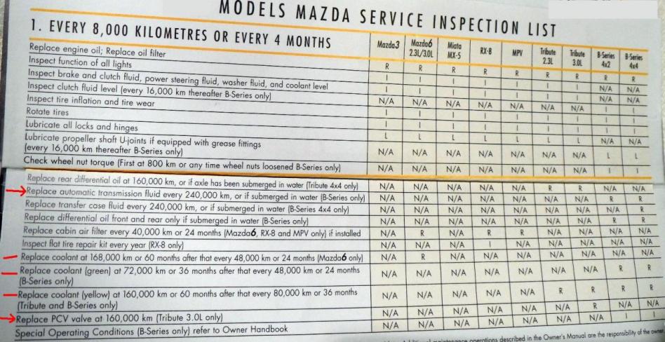

Finally decided to load up a service schedule pic that i was given. N/A means Not Applicable --- really, who are you kidding Mazda.
Indeed, your prying eyes should be everywhere and a few lousy dollars of prevention can save you from a lot of trouble. They are taking "maintenance free" to far.
Couldn't have said it better myself!
You do have a way with words!
Thanx muchly.
I am for preventative maintenance. Everything is cheaper than replacing a catalytic converter! Not changing spark plugs or ignition coils or changing PCV could all lead to excess stuff entering your catalytic converter which is very costly. Like the old saying, "you can pay me now or pay me later". The later is always more costly. I am not sure how much abuse a catalytic can take, but i don't want to experiment with it. Today's cars have the pre-cat built in to the exhaust manifold and that's the reason why they are expensive.
