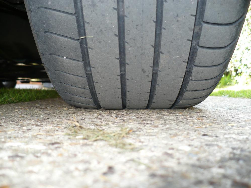

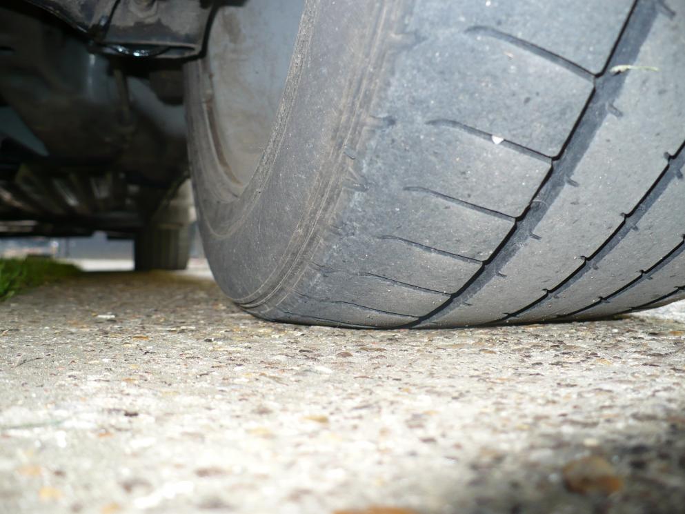

We got our new Mazda 5 in July 2008 (08) it was the 2litre petrol Sport. Now at 14500 miles the inner edge on all tyres is 'smooth'. Though the normal thread area is very good with the worse thread depth at 4.2mm, and that was to the wear indicator bars on all tyres not the total thread depth which would therefore be in the order of 5.7mm. I'll try to add a picture.
I have conposed a short e-mail to send to my dealer (4 miles away). I plan to call MMUK some time next week to log the official complaint. Then see how it pans out with the garage. I expect 4 tyre replacements. Even though a 12000 mile service since Xmas and no comment about excessive wear on inner tyre edges. This & more I will go into depending on garages 'response' to e-mail.

It's bizarre that in these mazda 5 cases that the legal limit is well within limits, as in having a total depth of well over 5mm yet the very edge of the tyre that looks like it shouldn't even touch the road (in normal use) can be so worn that in a short period of time I beleive I will see wire braid. See my pictures of this July 2008 petrol sport. You have to look carefully at the edge when you are inspecting, don't just look at the main obvious road tread. These tyres have covered 14500miles. Now I beleive that they are potentially dangerous despite the '... plenty of thread there sir!...' I got from kwikfit a month ago. I expect a vist to Mazda and a courtesy car while they 'inspect'. I rotated fronts to rear about the 10000 mile time. Just prior to the 12000m service. The fronts are now looking like the original front tyres now.
If these tyres are not monitored specifically at this location on the tyres there would, surely, end up with a lesser experienced/competent owner having an 'incident' where the tyre carcass will seperate from the wheel, for definite.

I sent my e-mail with pictures of all 4 tyres (similar to above) to my Mazda Garage ( East Northamptonshire - but not Coventry). I got a phone call at 0905 on Monday arranging a session at the garage next Monday when they are going to take photographs and measurements with their equipment and send results to Mazda (head office I assume) where they scrutinize the data (tyre depth, wear & mileage, I assume) and apply a proportion for me to pay for replacement tyres. I asked at Mazda UK do they have some protocol they can send me as to what they are doing. 'No!'. I'll let you know after next week as we have to wait 7 to 10 working days for reply.

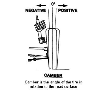

I'm temped to go and get some laser tracking done & get a print out, from a tyre 'specialist' type garage. To compare. I am interested in the Camber value

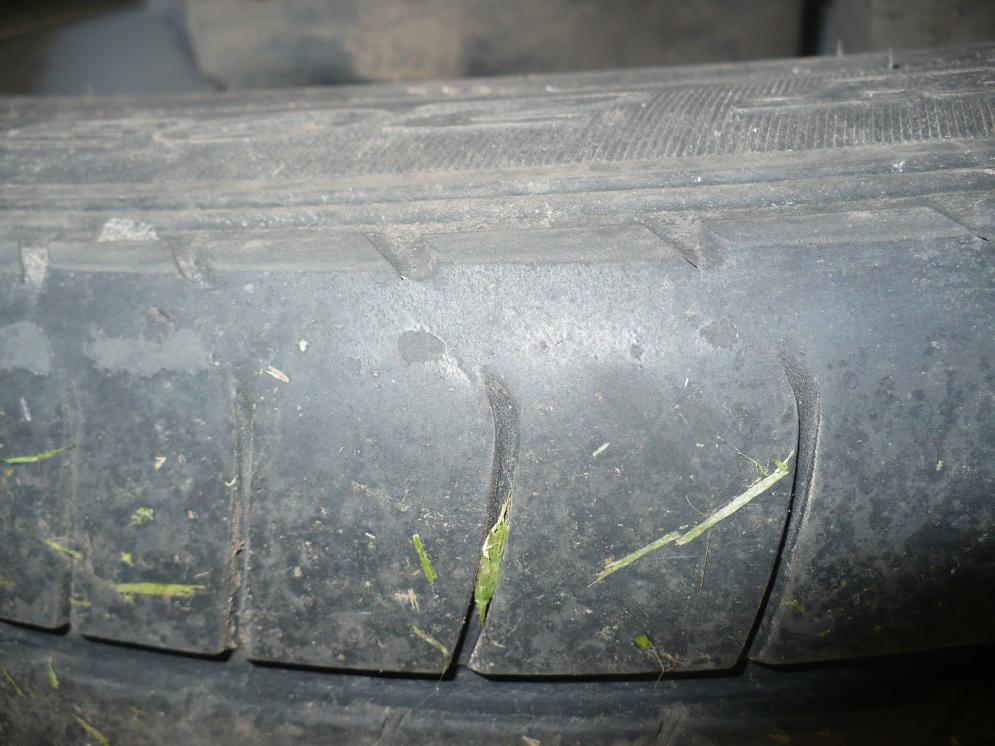

I take back what I said previously, at 7,800 miles one of our front tyres is blistering down to the second layer of rubber on the inside edge !

Is it your Near-side (N/S) or Off-side (O/F) front tyre that has 'shown' first? Assuming you live in the UK driving on the left with a RHD car.
My Mazda garage took photos today of all tyres and filled in 2 pieces of paper with photographs of the Dunlop tyres with markers indicating the 4 main grooves around the tyre were they had to enter all the depth values per wheels. Mine were all 5 & 6mm. Though when I got home I measured again with digital caliper & got values from 5.3 to 6.6mm. The other piece of paper had what to look for on the edge. I asked for a copy but it was declined. I didn't read what either said. They said they'd send them off and call me in a few days. Covered 15100 miles, no 'feathering' or outer tyre scrubbing. As the tyres should be except for the inner wall/edge wear generated by the front.
NSF worse although there is not much in it.

I think that the -ve camber is an issue that I believe is made worse on the 17" rims as I think they are wider and have a different offset to the 15/16". (would need to check this)
The combination of the change in offset and the -ve camber that the vehicle probably has as std makes the wear more evident on the 17" rims.
However I also believe that the dunlop 2050's are not up to the job and hopefully a change in brand will at least improve matters.
Heres a pic - if you zoom in you can see the blistering:
