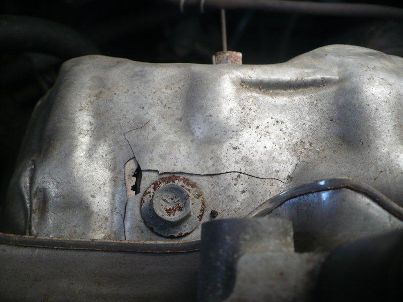

I had my heat shield replaced 6 months ago back it had cracked, at about 1 year old. It made a tinging noise as the engine run. It lasted months while my local Mazda tried to order it or forgot it. The failure looked to me like fatigue (stress) failure (like infamous aeroplanes had). See my picture to understand and hope everyone else has a look at theirs. to find it....open the bonnet, prop it up (dah!) and standing at the front of the car look behind the engine and down the back (best if the car is facing the sun to illuminate the shiney metal. If cold tap it or flick or bang with a screw driver to hear the sound.
