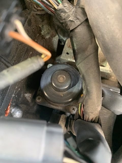

I hear a slight hiss from the device shown in the pic but not sure what it is, the hose from it and to the throttle body is not leaking however.
Any ideas? Appreciate any feedback.

Ran a smoke test and see a leak from this device but not even sure what it is. Can someone identify it?

Found it, EGR.
Old Jun 18, 2020 | 06:16 AM
Looks like the EGR to me.
