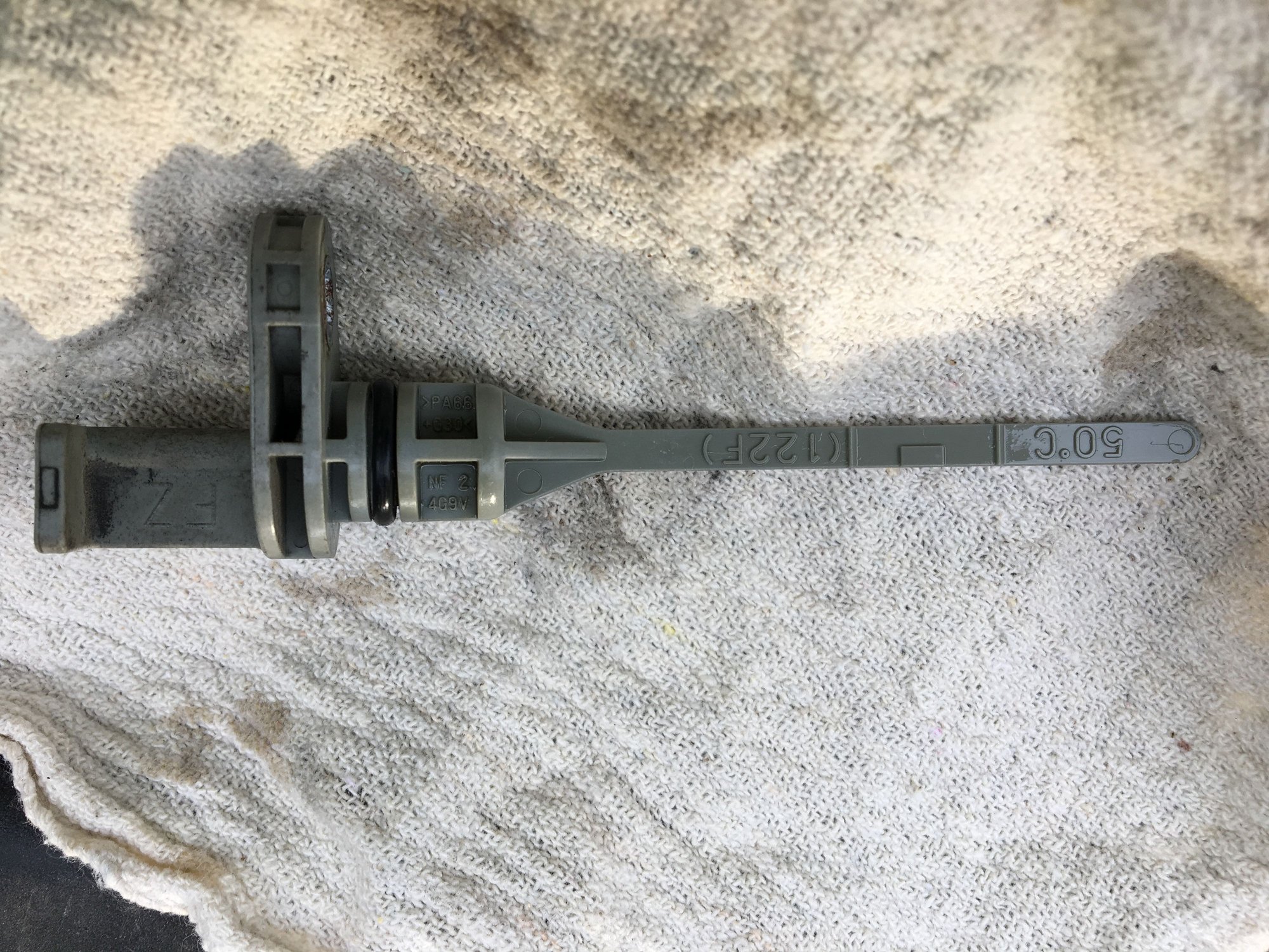

I have added some pictures of the stickers on trans and trans dipstick.
I believe this FZ number is just the dipstick part number
For the skyactiv model, genuine fluid is "ATF FZ" . DO NOT USE Dexron or Mercon fluid.
They run a strainer rather than a filter, it won't hurt to replace it, just make sure it comes with new o rings. The Pan has no gasket, it uses sealant instead.
