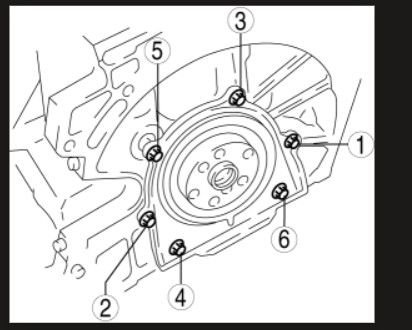

rear main oil seal housing (the component that holds the rear main seal) has a specified torque of 9 Nm (6.6 lb‑ft)
