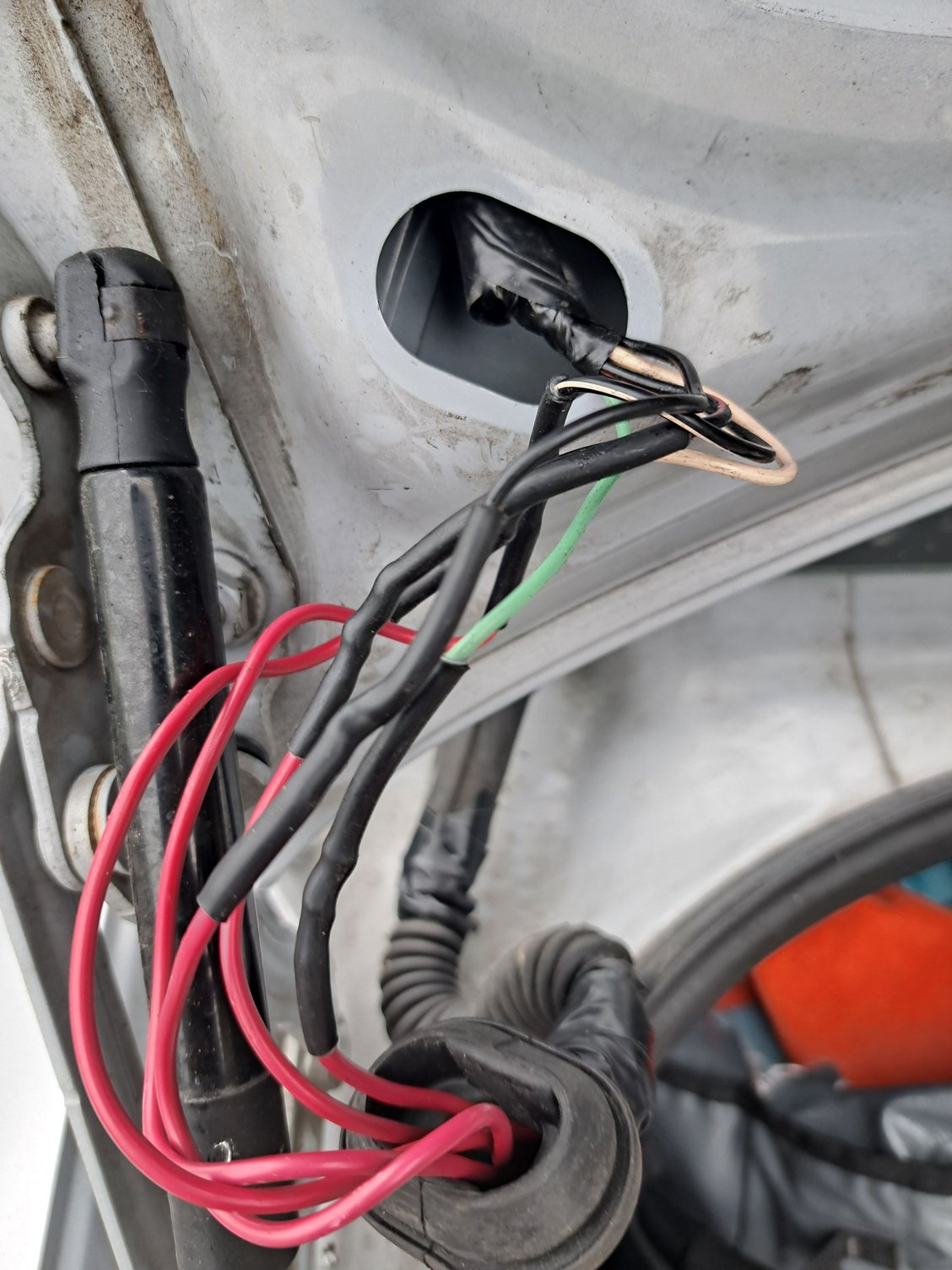

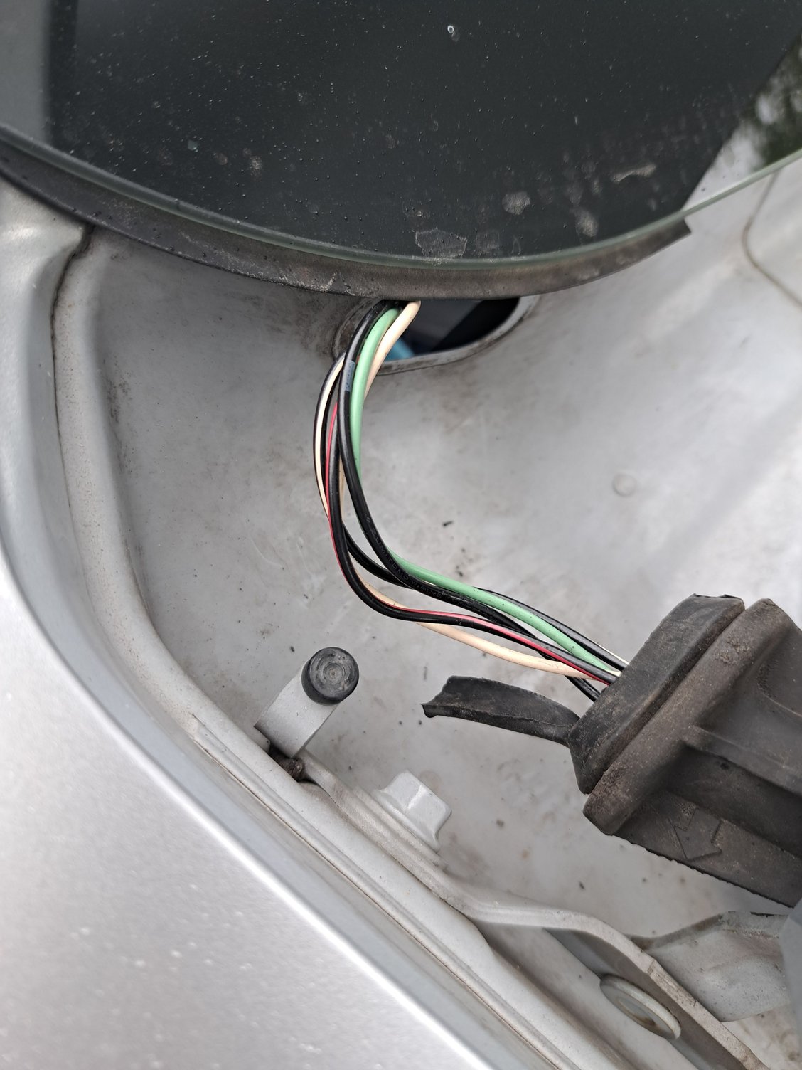

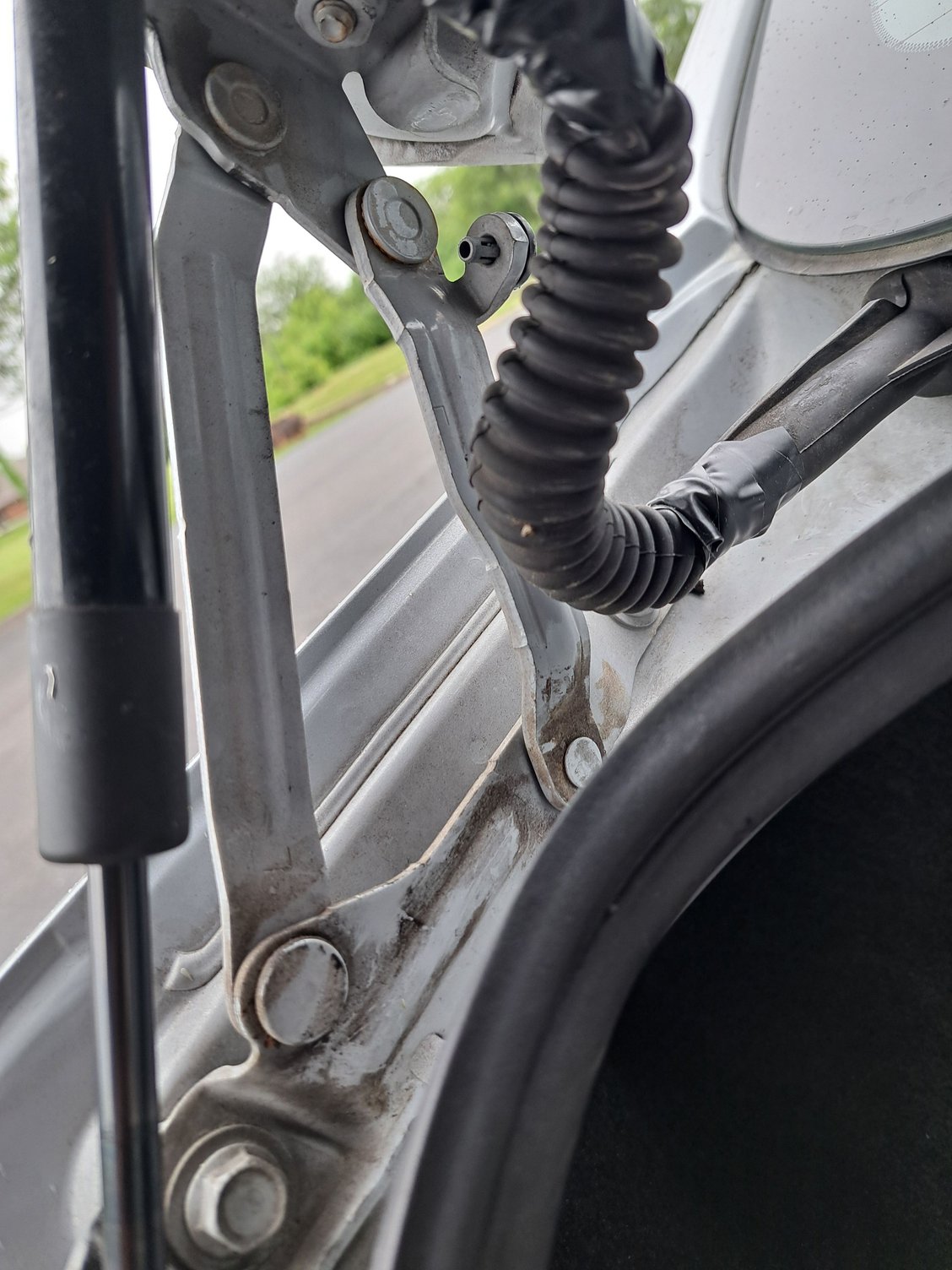

I was doing one final sweep around the car before taking to the shop to fix the blowing fuse. I was checking the rear high mount brake light wiring. I noticed that the rubber connector hose, that the wires are in between the body and trunklid, was loose. In the process of checking I gently tugged on it and it totally came away with the wires inside. Apparently the trunklid hinges had severed the 5 wires inside the rubber connector. I spliced, soldered, and heat shrank new wires in there. the rubber boot hose had no slices in it, but the wires inside were severed. If I hadn't decided to just check that wiring, I would have had the shop charge me $250 to find that out. So if anyone else is blowing brake light fuses, check inside that rubber boot hose.

I used the same gauge wire (16 ga) as the existing wires. I'm wary of changing gauges between wires because of resistance and heat. Going to a lower gauge might have worked but I only like to repair once and forget about it then to try something different that may work but will always be on the back of my mind.
