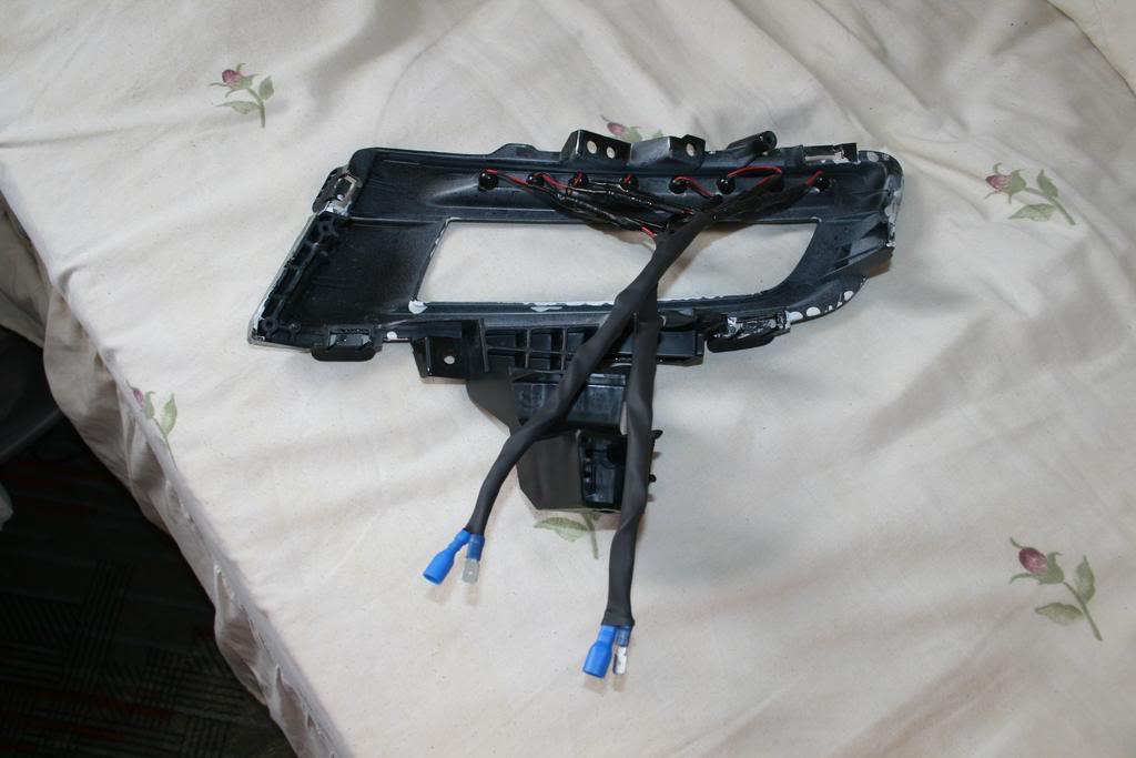

As an example here's a picture from m3f. A member installed eight pre-wired superflux LEDs (what I used) in each fog surround as DRLs and then just spliced all the wiring together. He has them separated because he did four white and four amber (white as DRL and amber with the parking lights). You can see how large the wiring bundle is there.

I think what Richard means by "series-parallel" is that you'd wire several LED clusters (either 3 or four) with the LEDs in each cluster wired in series with a resistor. Then wire the individual clusters in parallel.
