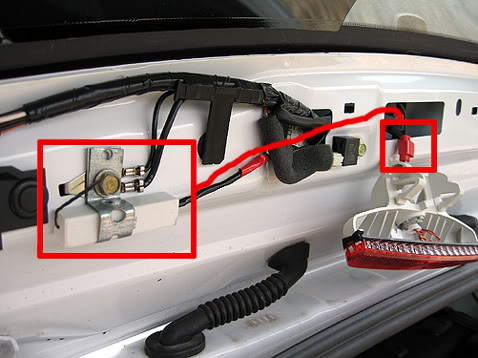

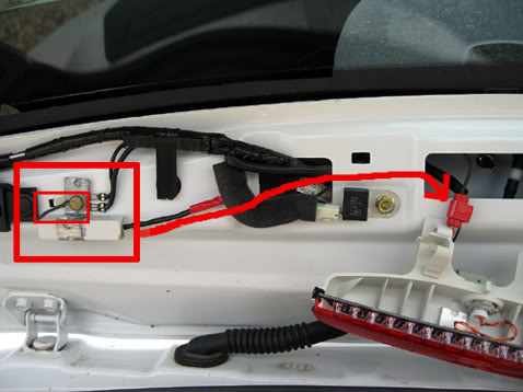

I put in LED bulbs and a third high-mounted brake light LED assembly and had problems with leakage that affected the turn signals and cruise control.
I had the bulbs in first and didn"t have any problems until I went all LED.
An 8 ohm, 25w resister across the wires (+ & -)to the third brake light and stashed
up inside the hatch trim solved that problem. Here"s how it looks w/the trim off.
