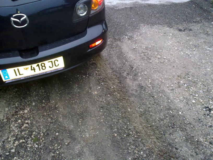

Hey everyone, have a curious problem that is intermittent and not reproducible on the 3 in my sig, it just happens when it happens. Problem is my parking brake works normally, the handle stops at the 4th click with normal force and the brake holds normally then it could be the next time I use it (if on paper routes could be the next minute) the handle will go almost to the very extent of its travel OR at the extent of its travel and the brake will not hold well on an incline. Attached are two pictures taken within 5 mins of each other, the first shows the brake when the handle goes right to the top, the right brake as you can see is NOT working, the next pic the handle worked fine and as you can see the right brake worked.
My dealership told me there is a ratcheting cam type system in the rear calipers that push the pistons (showed me a new caliper) but I am not 100% convinced this could be the problem, it does make sense but I want to be sure before I spend over $300 on new calipers for the rear. The dealership could not reproduce the problem to verify it though, they are just guessing.
Any other ideas on what it could be or any support for the dealers theory?

There is a ratcheting system in the rear calipers. When you replace the rear brakes (and compress the pistons) you have to pump the parking brake lever about 20 times to get them back into position.
Have you replaced the brakes in the rear? If so was it recently? If not have you checked to see their status? In some years of the 3 the rear brakes actually wore more quickly than the front, and the inner pad tended to wear much faster. I don't know that being worn a normal amount would cause this issue...... certainly shouldn't cause an issue with the brake lever itself.

Brakes are original but need to be replaced, they did pass inspection but just barely. I have kept an eye on them and they are getting thin, fronts need to be replaced as well (rotors included).
Lets play hypothetical: Lets say the pads are worn down, this means the ratchet system has to rotate as the pads wear to keep the parking brake in spec, this means that if I get new pads the ratchet might be turned back to a point where its not "worn" on the teeth (if that is my problem) and work properly again until I hit that point in the ratchet.
Does that make sense? Would it be better to just get new pads and see if that fixes this (at least until they wear down again)?
Yeah I cant quite picture how the handle travels all the way to the extent of its travel either, I can imagine that the arm that pushes the ratchet in the caliper slips and the cable just pulls it fully but I haven't seen the guts of the caliper to be sure that is what happens.

Well if the pads are at the end of their life you'll need to replace them anyway. Might as well do those and see if it makes a difference, and if not see if the calipers need replacing. You may be able to find replacements off of a junked car. IIRC the Mz5 uses the same caliper in the rear (just a longer bracket for bigger rotors) so that would increase your donor pool.
