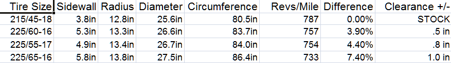

Ditto on the ground clearance for my 2017 Hatch.
Living in Maine and having a long gravel , steep grade drive way more clearance would be a plus.
I will be exploring larger tire diameter options.
Pete
Old Feb 26, 2024 | 03:01 PM
Mazda5Newb's Avatar
Joined: Jun 2019
Posts: 8
From: Portsmouth NH
Default Playing with Alternate tire/wheel size combos to increase ground clearance
I'm going to look for 17" rims. My goal is a also a softer, smoother ride as well as a bit more clearance.
Pete
