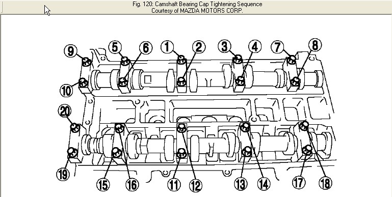

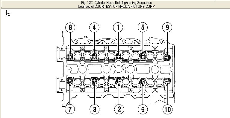

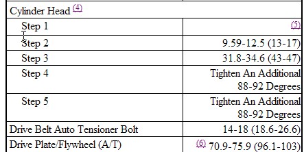

I need help guys, 2005 mazda3 hatchback 2.3L any idea on toruqe specs for the cylinder head. and crankpully
Thanks...
Old Jan 4, 2013 | 02:21 AM
racer662009's Avatar
Joined: Dec 2012
Posts: 103
Crank bolt should be set around 74 ft lbs
Hope this helps!
Attached Thumbnails mazda3-2009-09-19_212941_t2.jpg   mazda3-2009-09-19_213015_t3.jpg   mazda3-2009-09-19_213050_t4.jpg
