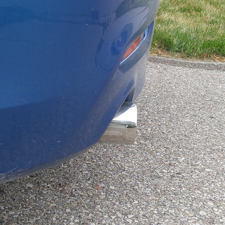

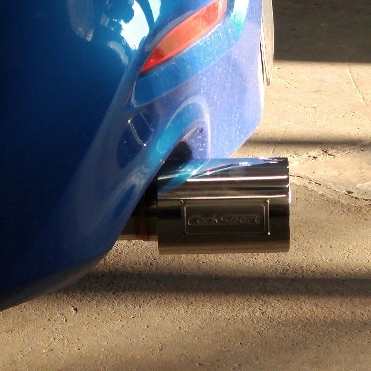

Hi Everyone.
Well, picked up the corksport sedan exhaust for the hatchback we have and installed it.
Everything matches perfectly, as expected. (hangers, bends etc.) the sedan pipe is quite a bit longer.
Took it over to the local stainless muffler guy and had him cut off 4 inches from the tailpipe section.
All good now, son is a happy camper with the sound. Mom is not
