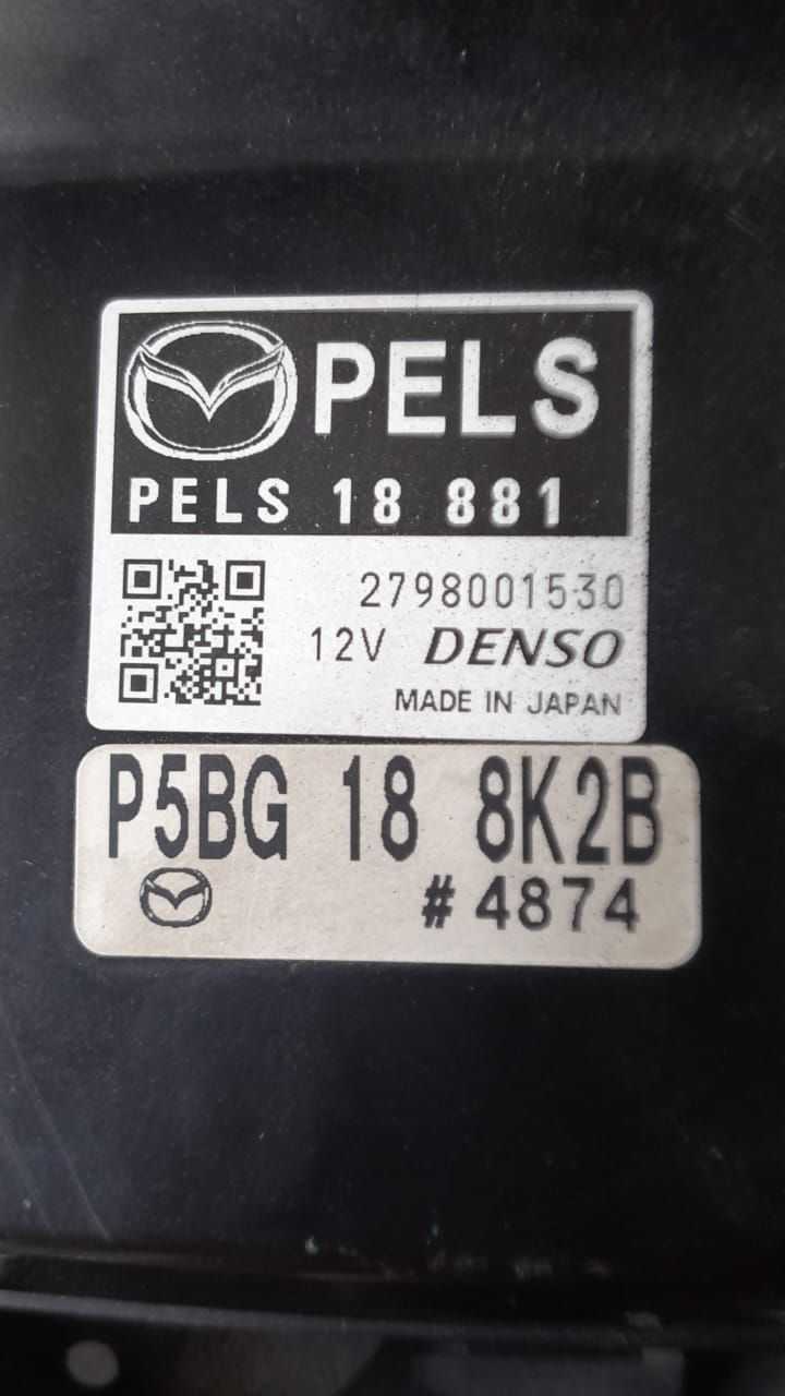

Good day. I'm looking for a ECU for a 2015 Singapore Mazda 3
THis first pic is the original ECU. The 2nd is the only one I'm getting. Will it work?
Old Aug 6, 2024 | 11:28 PM
Posts: 10,664
It is not a good idea just to get a used ECU. But if you must do it that way you will need to have a Mazda dealership flash the ECU to the latest or last version for your VIN .
Or you would need to find an independent service shop that can do what is called a ECU pass-through which is essentially the same as a dealership only of they have the latest ECU version for your VIn so make sure before you pay them for the service.
The better idea is find a retailer that has a ECU rebuilt for your VIN. That way you will get a proper ECU and ECU flashed. Plus a warranty .
