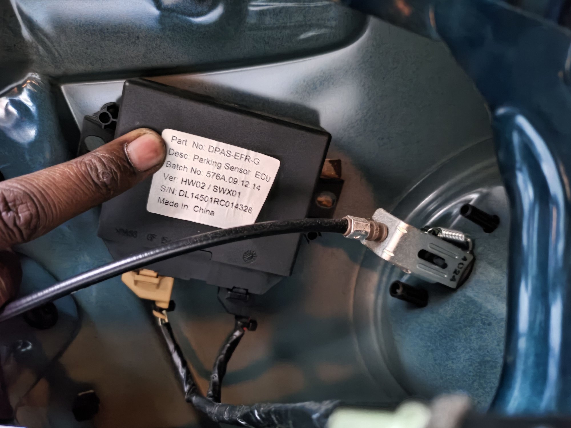

2. This car got the rear parking sensors(I mean, no reverse camera).. unfortunately they are not working! but, somehow blindspot indicators are working when reversing the car. I tried to diagnose the issue by tracking down the connetions from sensors to "dpas-efr-g" module and checked the 2Amp fuse. Everything looks normal.
Can anyone has an idea about these issues, please help me out.
