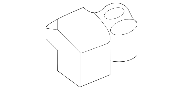

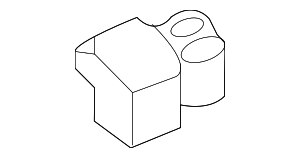

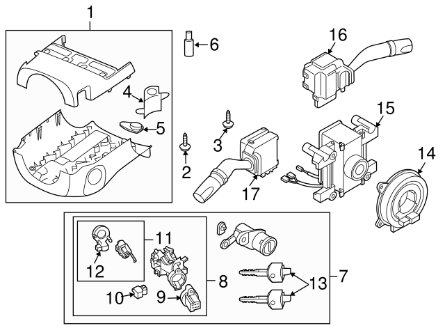

Thanks I finally found this FORUM and was able to access your information, they checked my vehicle in several places and none could define the problem, finally they all told me to take it to the Mazda Dealer because they even tried to verify with a Scanner and it DOES NOT allow ACCESS in the Computer to the BCM area, finally yesterday I went to my nephew who is a Ford Technician and after using the scanner again and NOT being able to access he came to the conclusion that the problem was that the key reminder switch did NOT detect that the key had come out but he did not know exactly what was NOT working, when continuing to search in MAZDA PARTS for the starter cylinder I could see in the diagram THAT SMALL PART THAT IS THE KEY REMINDER SWITCH, which by the way has a ridiculous cost for the problem it presents, after continuing to search and finding this forum I am very hopeful that this is the problem, I will try to buy the part and replace it and obviously I will let you know the final result. I share the information about the part in MAZDA https:​​​​​​ Key Sensor problem-71b2c9da98c3ce256fdd87d1dde4e085.png  Key Sensor problem-73f4618484e21d5082a8568d73f27f17.png
