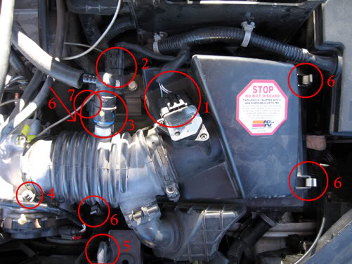

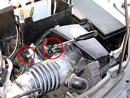

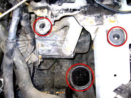

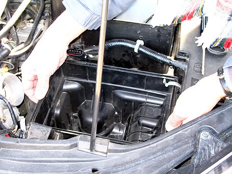

Do what "Spots" says, but lossen all the clamps and both electrical connectors, remove the top and pull straight up w/a jerk to remove the bottom of ther AB. It'll pop out of the rubber bushings it's held in place with.

wow thanks a lot. How would i get that other plastic piece out the resonator i suppose... the last bottom circle in the last pic.
Old Feb 7, 2008 | 06:23 PM
Default RE: How do you get to the air filter?
Pull out, or loosen the front lower splash pan and remove the three 10mm(?) bolts that hold it in/onto the frame rail. They are not as hard to get to as others might have you believe.

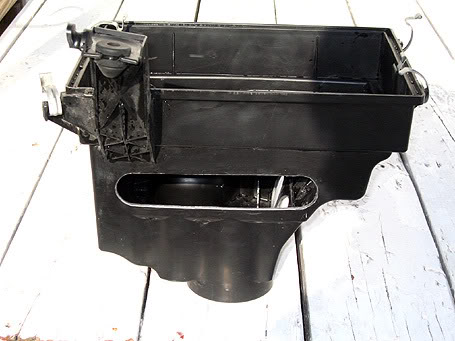

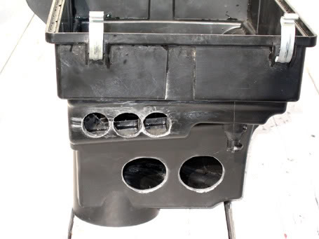

Well, I used one before the CAI... along with this little mod:
I called it the Poor Man's SRI and it worked, but the CAI is much different... better.
