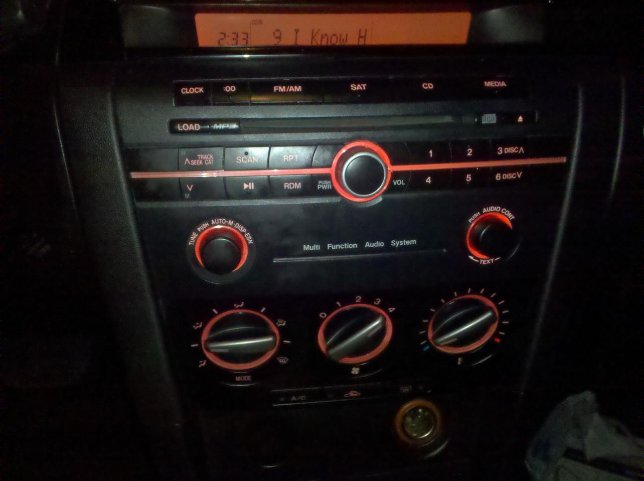

HEYYYY. Me again. Yeah i know. Dear God, someone help her. YES PLEASE SOMEONE HELP ME. first question: in the attachment, what is the official name of that version of stock radio. second question: how can i extract the radio, where do i extract it, what do i extract it with, how can i extract it without breaking it? i know that was more than one question. bare with me. the reason i want to do so, is im trying to see if the auxiliary cable got loosened or unplugged somehow. isnt it plugged in to the back of that? hahaha. and also, make sure to tell me answers to everything i asked please!!!! i love you. youre the best if you answer.

First of all, the name of that radio is Sam. I don't know why but it told me so when I opened the picture.
Now seriously, it looks like nothing but the stock OE std radio to me. Only if you have the GT model it would be a Bose.
Now, IIRC (it's been a while for me,)
1) Pull off the dashboard center trim. Start from the middle to release the clips and pull outward because the sides are slide in to a matching female, and you don't want to break those off. You have to bend it outward a bit (toward you) to release it completely. This will expose a couple of screw/bolts. More on those later....
2) Next remove the shift **** by unscrewing it counter-clockwise and pull up the shifter bezel on the console to remove that. It too is clipped in, so be careful not to break those clips. Pull straight up.
3) That will expose two screw/bolts that need to be removed below the ash tray compartment.
4) Once that compartment is removed and put aside, you should see two more screw/bolts as before. Remove those, and the two at the top that were under the dash trim to release the center console cover/surround.
5) Gently pull out on the console surround to release those clips. Once the clips are released, it should pull out freely.
6) The radio is held in with more of those screw/bolts. I can't remember if there are two or four, but they should be easily seen now. Undo those and pull out on the head unit, and you got it!!
Reassemble in reverse order.
That's basically it, as I can remember. It's not as hard as it sounds, and I don't think it will be necessary to undo any wiring, but it may make the job a little easier. Plus if you have the automatic, there will be a wired light under that part that illuminates the shift bezel at night.
Old Sep 2, 2010 | 11:11 AM
icspots's Avatar
Joined: May 2006
Posts: 1,526
^^ It's not necessary to remove the shifter/ashtray to get the HU out.
To the OP I posted instructions on removing it last night in your other thread..... you know the thread you already started....... on this same topic. :P
As far as what the HU is called I was going to go with Rupert, but I suppose Sam works just as well. I don't know what the model number of the HU is, however it looks like you have a '08.5 single CD/Mp3 HU. Aren't you still under warranty? If so and you don't find anything on your plug reconnaissance can't you just take it to the dealer and say it isn't working anymore?

Nope, only the dash strip and two screws need to come out to remove the HU.

See the instructions I typed out in her other thread. :P
