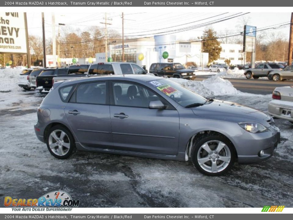

Cool, I asked because if you do have the carbon grey paint and are in the US then you do have a sp23. The carbon grey was an available regular color in some other countries like Canada. Incidentally check the sticker in the driver's door jamb for the color code. Carbon grey's color code is 28B. The way you descirbed it it really has to be that color since the only other gray color that year was titanium grey which was much lighter. For example.
Carbon grey sp23
Titanium grey
Yeah, the regular 3 just has 2.3 badges vs. the sp23 badges on the 'special' edition. You can see the badges I'm talking about in the picture above. In addition to the badges if you have the sp23 you'll have leather, LED tail lights, auto-wipers/headlights, etc. The reason I'm confused over all of this is I thought the sp23 came standard with HIDs. I know most of them had the Bose stereo, but apparently that was one of the single option packages. Perhaps HIDs were as well.
