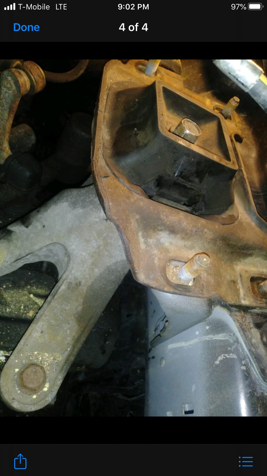

I am buyin new axles and I will look into the clips to see what’s going on and take better pictures of the car

Si they saw under the car and since I had it tilted when I rose it up I couldn’t tell but they saw that the transmission was too far down so the axle wasn’t going in straight ...so the transmission support was loose thanks for helping me out though I appreciate it
