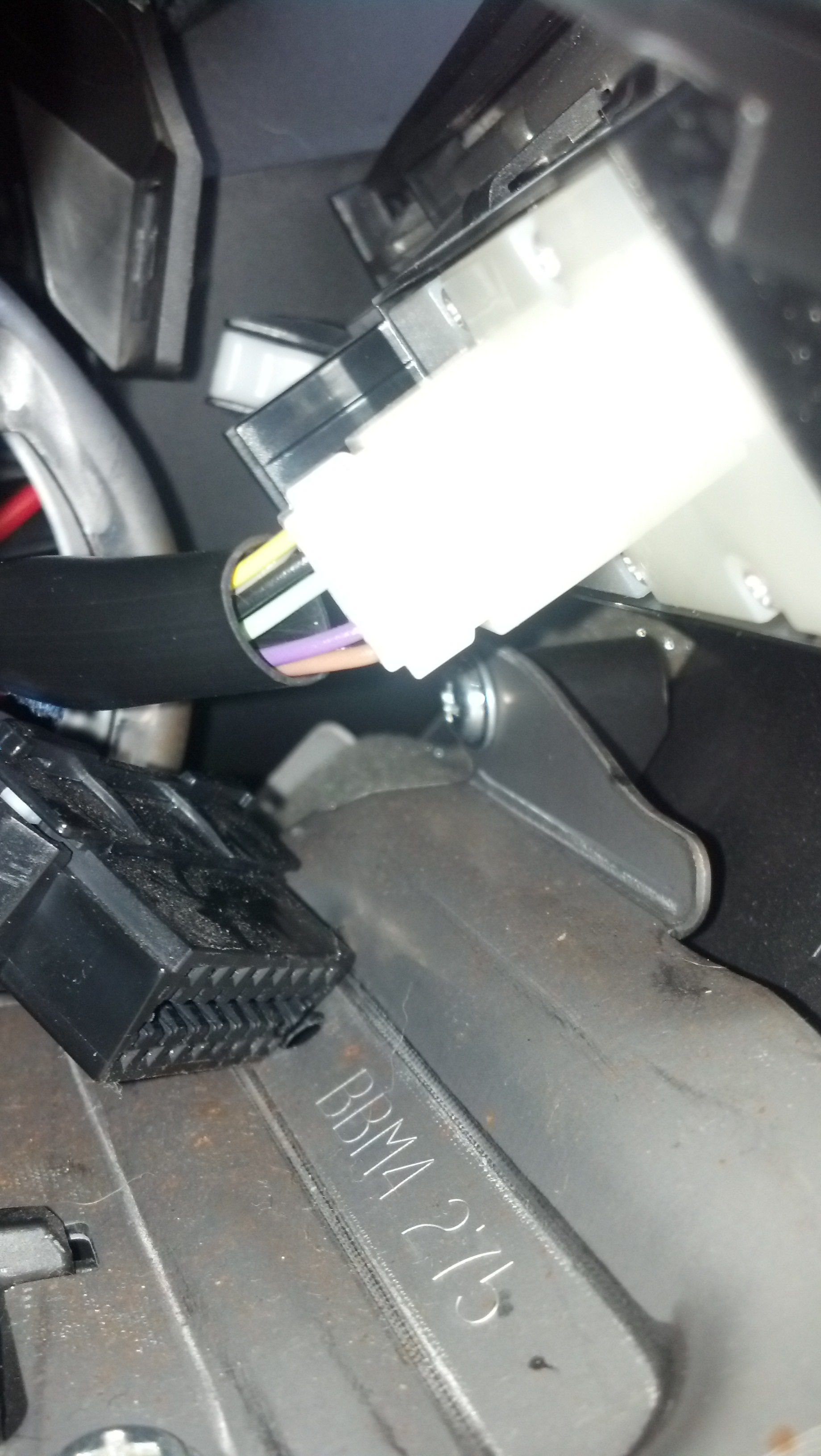

Figured out my problem. The actual plug behind the switch wasn't plugged in, must have fallen out somehow. Maybe this will help somebody else out someday.

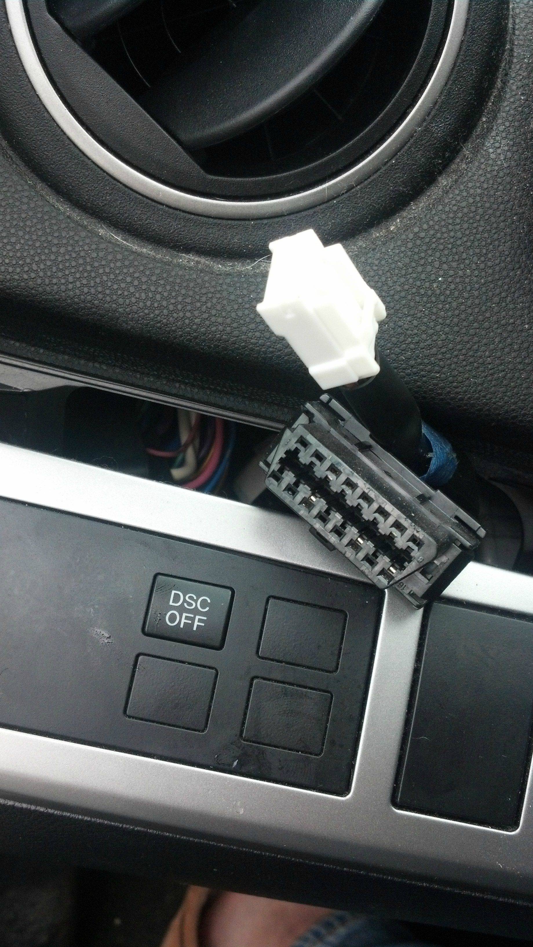

Plugged back in. There are other plugs stored back here for switches that aren't optioned on the car.
Works fine now.
