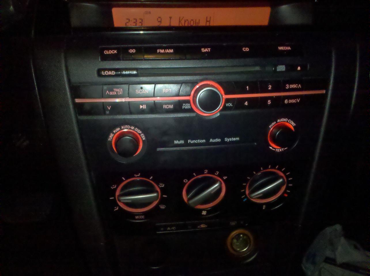

Yeah it says aux! But my cd changerlooks like this (in attachment) and how in the world do I open that up?!?! (16 year old girl here... not a car mechanic... hahahahaha)
Hmmm. If it's displaying "AUX" when you push the MEDIA button then that means the connection at the back of the HU should be fine..... or at least it's making enough connection that it recognizes something plugged into it.

First off I'm not really sure why your wreck would have caused any issues with the HU, especially with the button. I mean wtf? Do you know if the ACI worked after the wreck but before going to the body shop? In any case it's possible that a connection was either jarred loose, either partially or fully causing it to give you issues. I'd suggest checking the connection at the back of the HU, and under the plug at the armrest end. For this you'd need to disconnect the plug and then reconnect it.
For the plug at the back of the HU you'll obviously need to remove the HU from the dash. This is really easy, requires only a phillips head screwdriver, and will take only a few minutes.
- Open the glove compartment
- Remove the dash strip. This is held by 4-5 tension clips and one hook.
- grab the bottom of the strip on the left of the glove compt. (right of the LCD) and pull back to release the clips. Don't pull the far right back.
- once the clips between the LCD and right side are loose gently flex the strip to disengage the hook on the far right of the strip.
- disconnect the last clip to the left of the LCD.
- Remove the two phillips head screws above the HU. Note there are four screws here, two for the HU, and two for the section of dash above it. You only need to remove the ones for the HU.
- Grab the top of the HU (not the face plate itself!!!!!) and pull firmly towards the back of the car to release the tension clips holding it. Once it's partially out be careful not to let the HU's frame scratch the dash to either side of the opening.
- There should be three connections on the back: main harness (big plug) antenna (small round), and ACI (small rect. plug).
- Unplug the ACI plug (it's pretty hard to get out) and plug it back in firmly.
- See if that fixes your problem (you can just sit the HU in the opening, you don't have to fully reinstall it to test).
To check the armrest end:
- Open the armrest compartment
- Set the parking brake (remove any items from the cup holders)
- Grab the front edge of the armrest compt (back edge of the cupholder section) and pull upwards to release the tension clips. The gear shift surround may come up with the cupholders but you can just pop the two sections loose. Slide the cupholders up off of the ebrake handle and set aside.
- This is where I'm hazy as I've not seen one in person. The ACI connection should be accessible from there by reaching back.... should be obvious where it is. I believe there's a connection that plugs into the back of the plug in the armrest. Again unplug and replug. You may also be able to pop the panel (that has the 3.5mm connection) loose from the hole and into the armrest compartment.
Let me know what happens.
