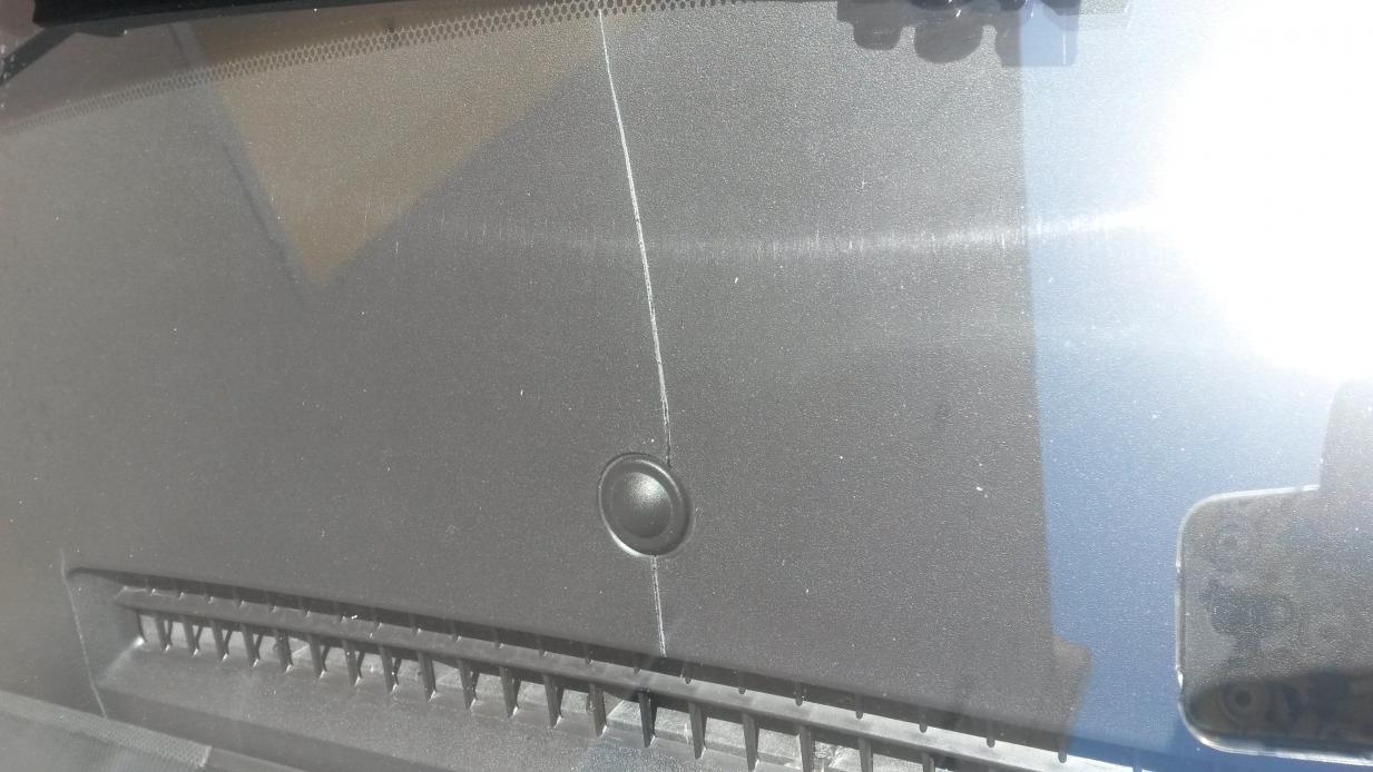

hi guys
anybody can tell me where to find this part of the car ;;;
Old Mar 5, 2015 | 04:53 AM
It looks like the Sunload sensor on a BK Mazda 3. Do you want to know where it is or where to buy a new 1?

I want to replace the part of dashboard where the sensor is.
Old Mar 6, 2015 | 05:35 AM
You need to replace the entire dash board.
Saying that, I know in Australia there was a repair bulletin, in which you pry & peel off the dash outer layer/top & glue on a new top. Part # was BAYR 60 710.
PM me if you want more info.
