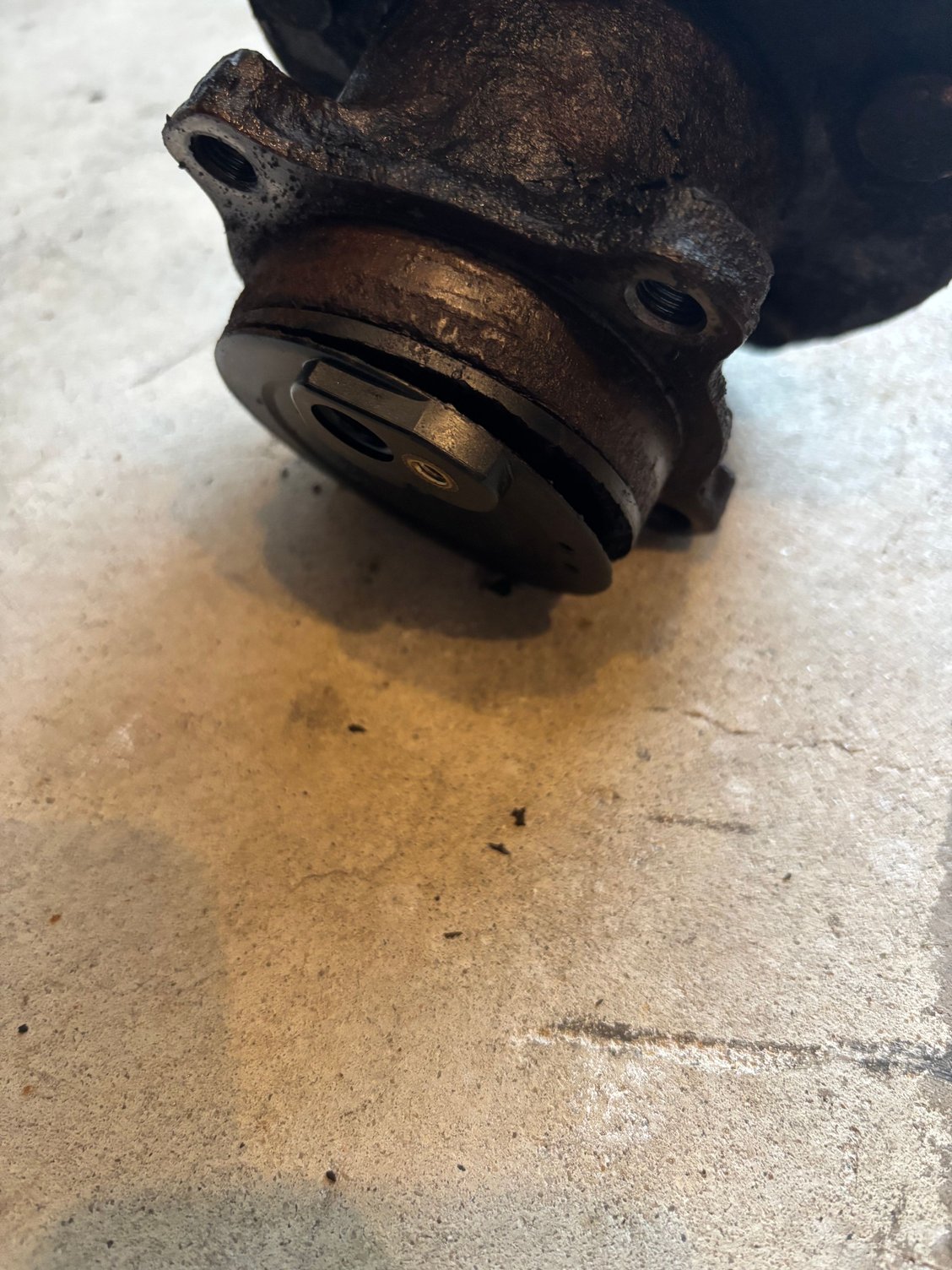

hey, thanks for the welcome. Nothing was changed at random. Both rear sensors had tone failures & the passenger bearing hub had a pretty severe separation where the sensor mounted to the rear (see photo). Apart from disconnecting the ABS harness and tracing the whole bundle for shorts, I’m not sure where else to look. Curious if anyone else has had similar issues.
