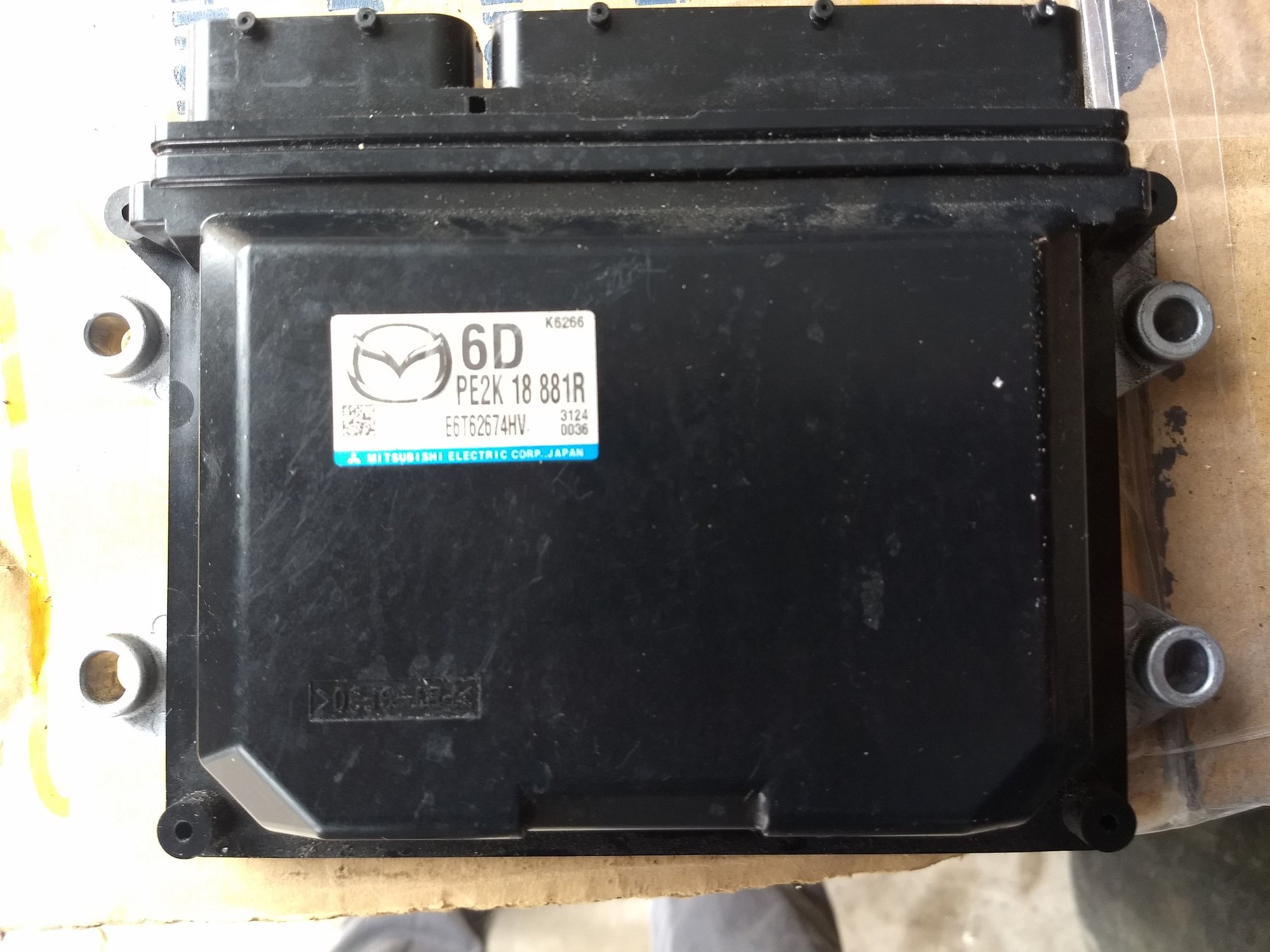

I have a 6 speed, and found what I thought was an ECM attached to the battery box. If it's actually the PCM that would be great as that is pretty easy to access.
I'll see if I can find out if it is a PCM and not just and ECM and go from there. If you happen to know where I could find that information more definitively that would be great, but thanks so much for the help so far!
Attached is a picture of what could possibly be the PCM that I pulled off the battery box.

Hey man, I think this is indeed the PCM!
https://www.xportautoparts.com/oem-p...LTE4LTg4MVI%3D
This is good news and points me in the right direction.
Now I can put all this junk back together and hopefully send this thing out for repair.
Thanks again for pointing me toward a PCM!
