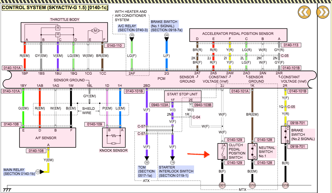

That link for the wiring diagram is great but I have a Mazda 2 2015 and need the wiring for the clutch engage switch for the manual (stick) version if its available.
It's a issue with cruise control not operating due to missing clutch engage/disengaged switch.
Thanks in advance Ross

Don't have any other M2 wiring diagram. It's not possible that's missing, your car won't start, maybe someone bypass it, not a good idea.
Anyway switch it's in diagram:
direct link: clutch switch
