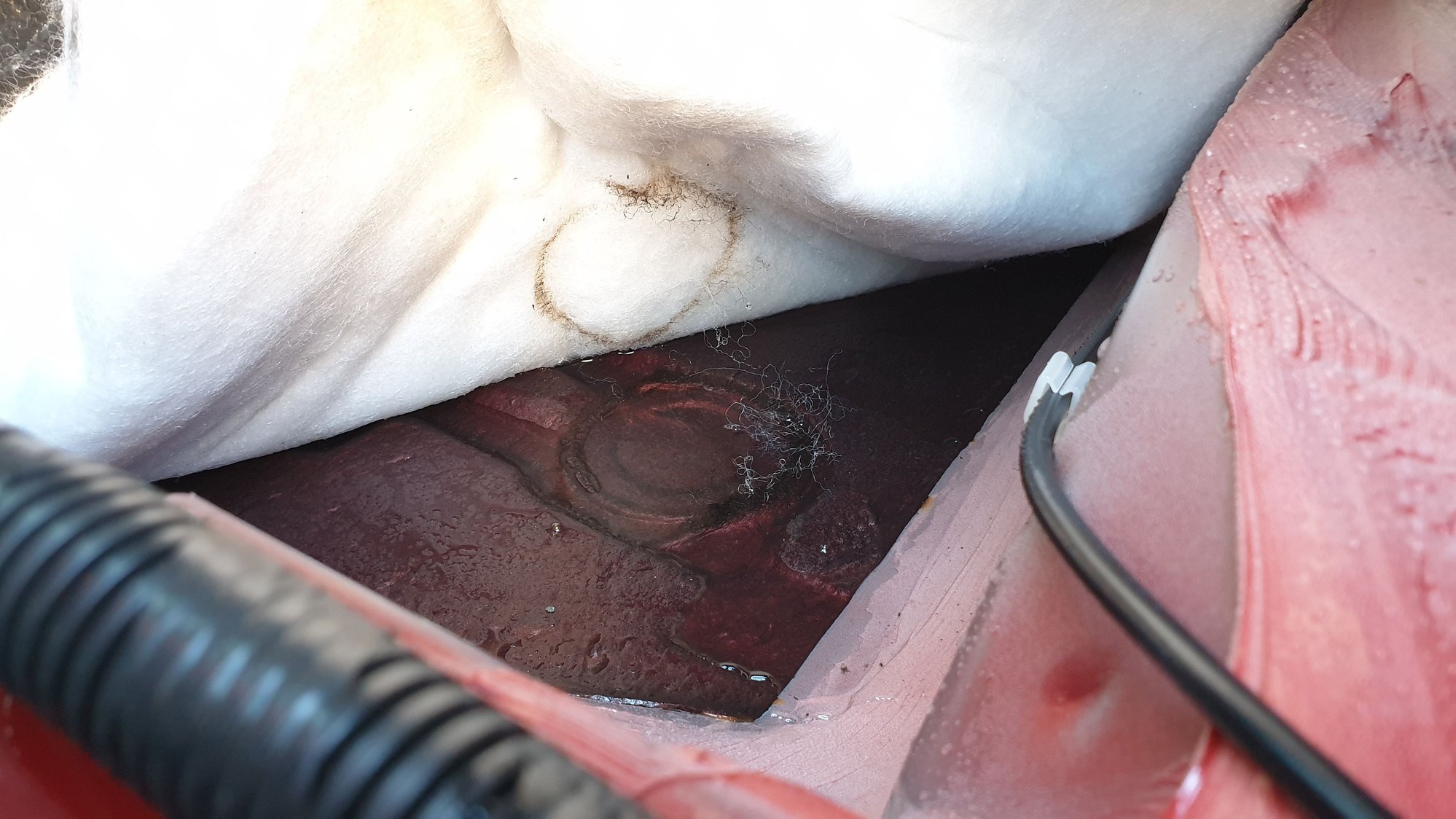

Checked in there today to get something out from under the passenger seat and noticed it was sopping wet! Then under the car mat in the rear passenger side it was soaked through!
Pulled the back seat up and it looked damp under there? Not soaked but some signs of mold patches that look fresh. Then pulled the carpet up and there was a massive puddle under there and the carpet lining is soaked through!? Had to leave it up in the hope it will dry over the next few days.

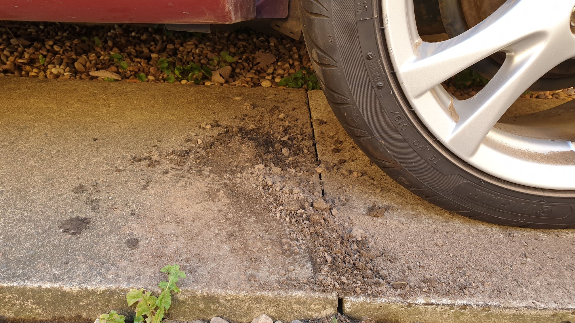

The car was originally from Devon so I will admit the rear arches are a bit caked up with mud (emptied these out today)

I found the issue. There was a split in the rear quarter seam below the rear lights. Found it by getting in the boot when it was dark and shining a torch in there whilst the wife sprayed the back panel with a hose. Loads of water poured in then filled up the spare wheel compartment and ran down the back of the rear seats into the rear foot well.
Looked as though a past owner had clipped a the rear quarter which had split the seal. I got rid of the car in the end.
