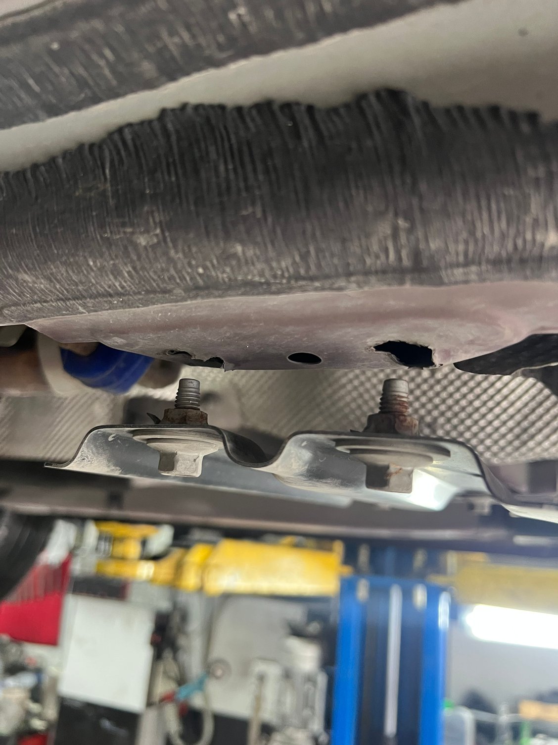

I remembered something very important ….
during the oil change there was a bracket under the car which was broken. The mech welded it and i am 100% sure he didnt remove the battery terminals as the car was jacked and oil was draining.
attached picture of the bracket.
ps. The certified mech replaced the battery and alternator and still the issue exists.

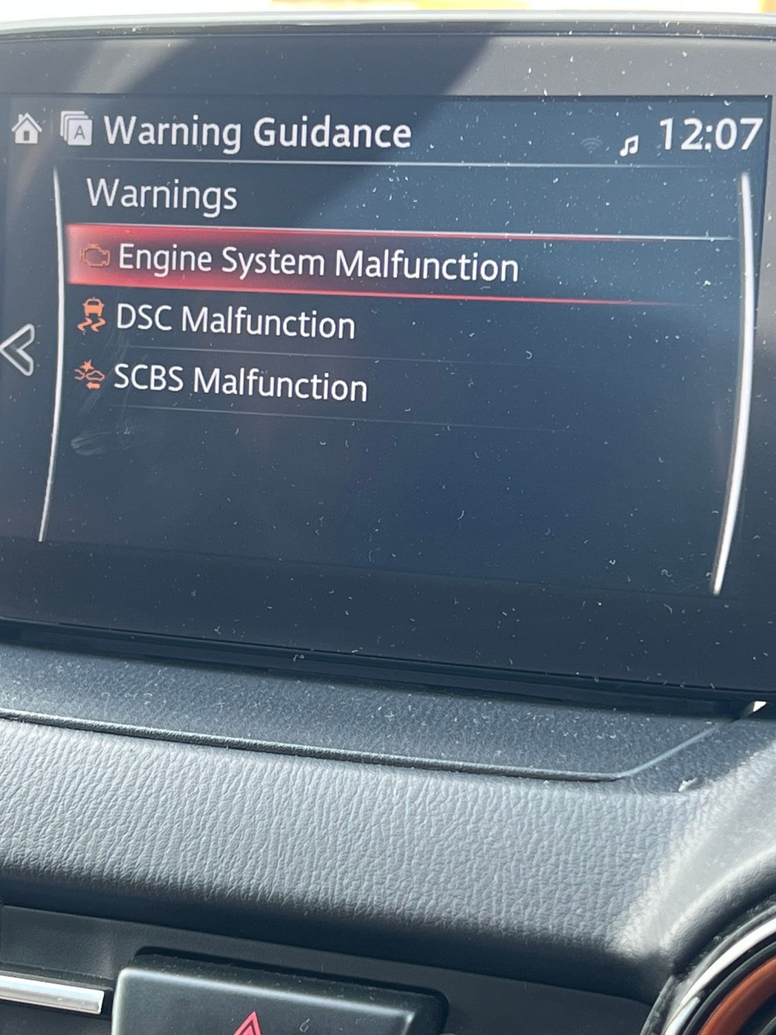

these are the codes from the latest diagnosis
