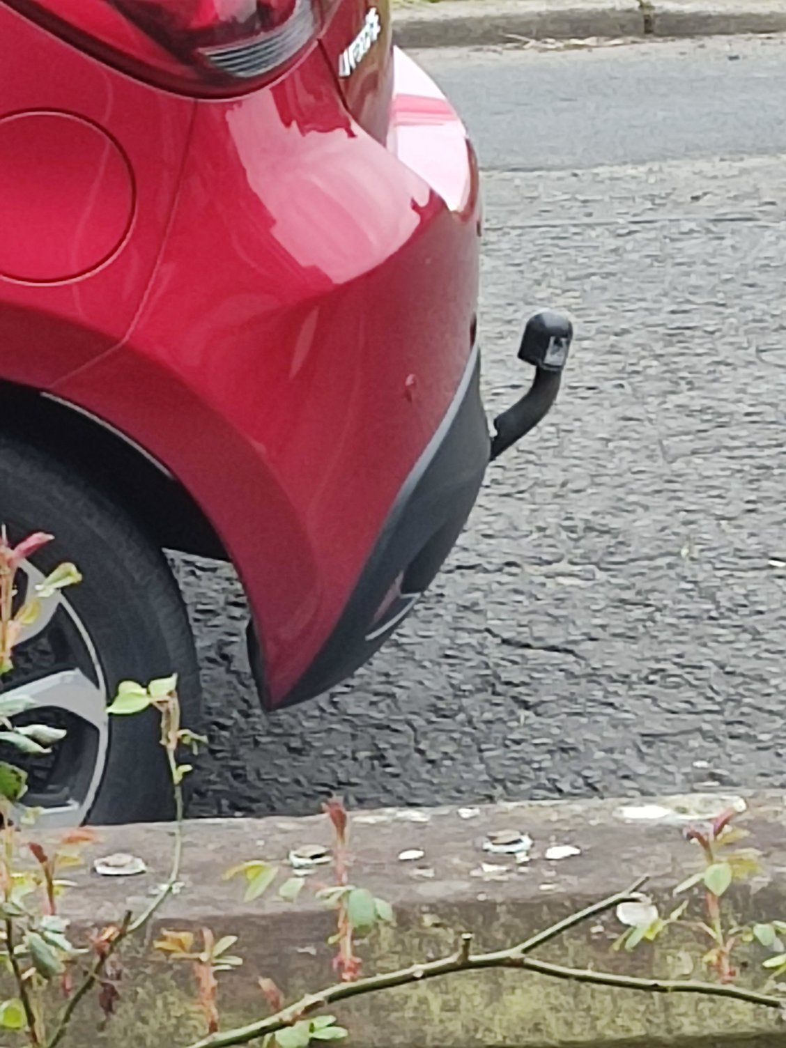

I have a fixed Brink towbar that has no effect on reversing sensors. Mazda 2 2015
