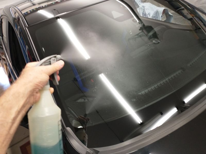

Here you go I made these this morning just for you.
Please notice that I use a NEWSPAPER for the final wiping.

Old Aug 28, 2022 | 09:58 AM
Posts: 10,665
Originally Posted by foxleybob
Nicely done sir.
Newspaper eh, my wife uses newspaper & vinegar to clean the inside of our patio doors.
She reckons her mum used to do that
Yup I don't because I do not care to have my figures smell like vinegar ... LOL
Actually, the absolute best glass cleaner is a product that is no longer available in the USA. crushed and powdered rice hulls.
The nespaper is old school but sometime old school is new school for many and still supremely works to dry glass.
