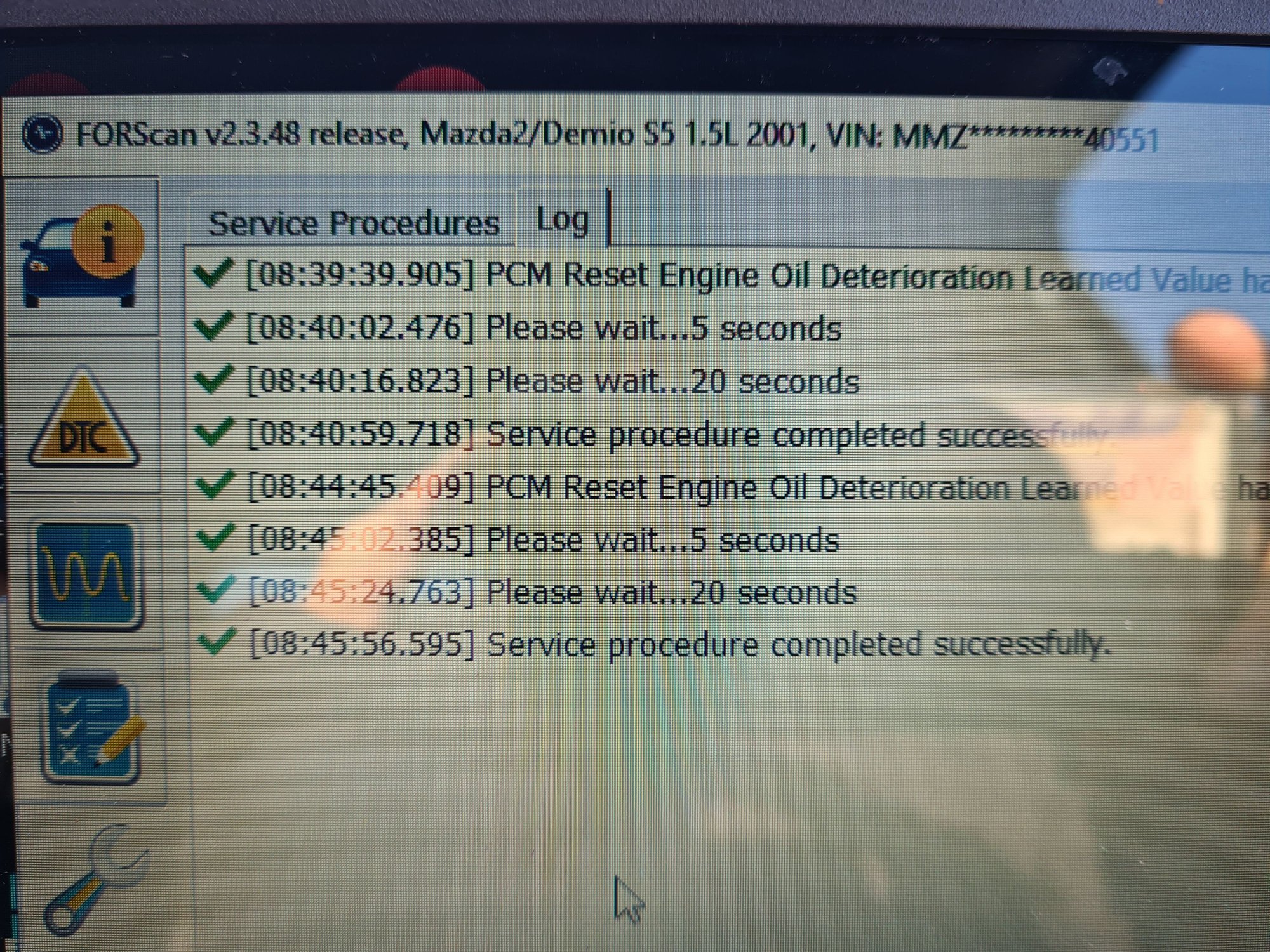

I did the following at 40k:
Reset service light with trip button
https://erwinsalarda.com/how-to-rese...ance-reminder/
Reset service and oil change via information screen (see note)
Reset service using ForScan
ForScan and ODB tool showed no faults

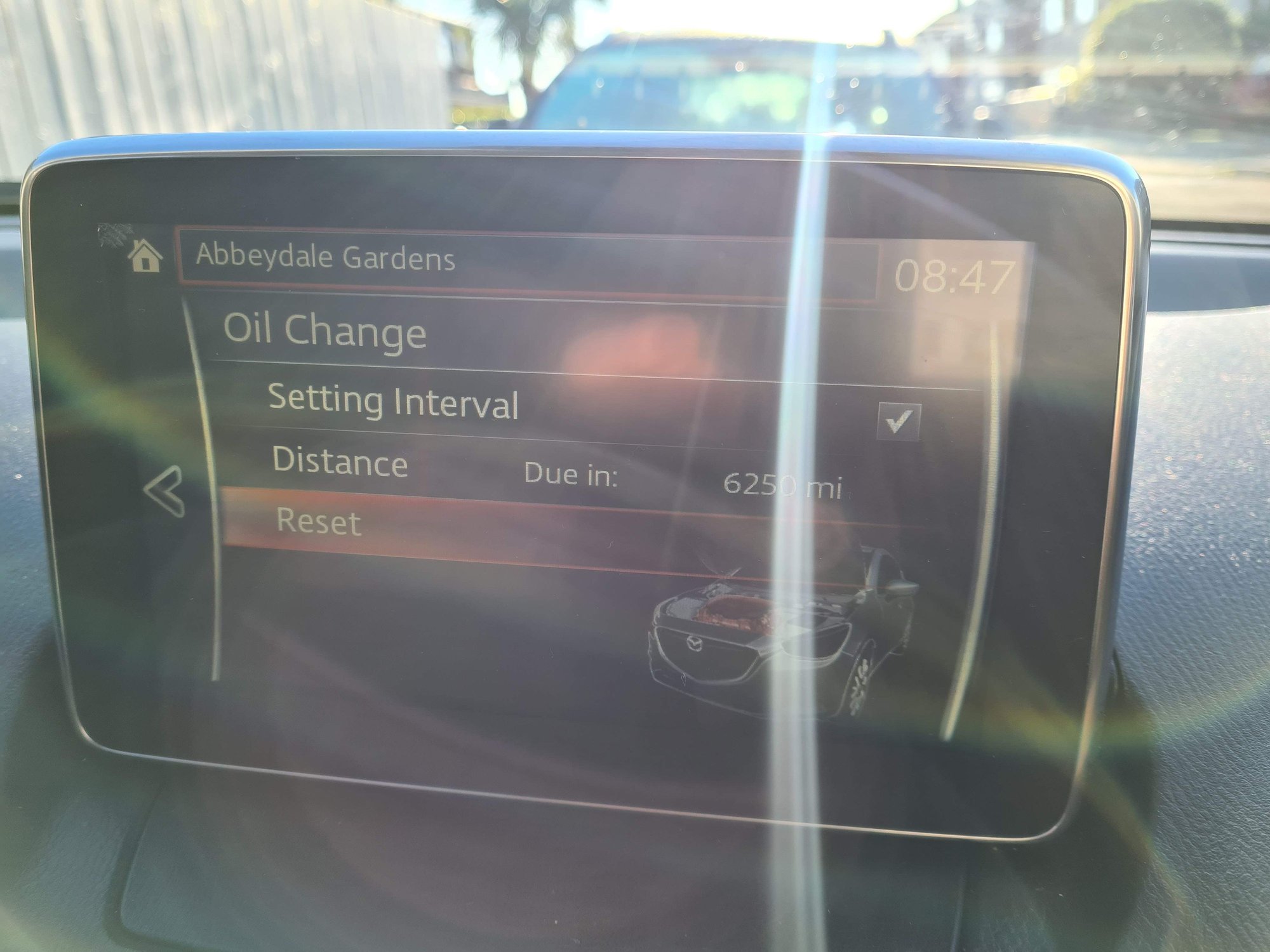

Despite all of the above the information console still showed oil change due in 6k miles (this is a secondary issue, as car has not got to 12.5k miles since either of last 2 services).
This 6k warning is consistent with the non Mazda service company having reset the service schedule.
I do not know when I might have access to this car again, with ForScan and would prefer to advise driver what to do.
Any suggestions on how to do a lasting full reset (with or without ForScan) or suggestions to find and eliminate cause of service light would be appreciated.

Diesel right? the water/fuel separator must be drained once a year (12500 miles) and replace filter every third year (37500 miles) Owners Manual
Now to reset spanner light it needs an advanced OBD scanner or IDS (dealer). I don't think Forscan can reset it but you can post a question in their forum.
