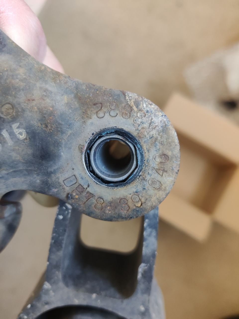

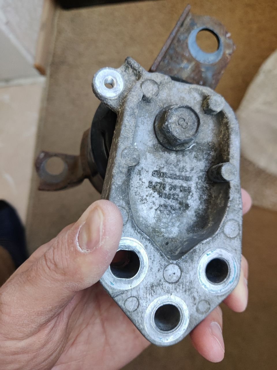

Вместо DL58-39-060A чудесным образом встал крепеж от Ford. А именно Lemforder 39442 01. (первые 2 фото - разобранный оригинал, 3-е фото замена)
Вместо DF78-39-040 также чудесным образом встал Ford SWAG 50 93 0057 (посоветованный специалистом Ford). (первые 2 фото - разобранный оригинал, 3-е фото замена)

DL58-39-060A it is according to the catalogue (on the part itself, after dismantling, it turned out that for some reason on it is indicated marking DF78-39-060)
DF78-39-040
When looking for equivalents, the catalogues offer nothing. Only except the original (Mazda's greed be damned). And the originals cost a lot of money. I went another way. I started to order parts from Ford Fiesta VI 1.6 TDCi 2010 (with engine code: T3JA, TZJA, TZJB) and bring them to the masters to try to put them. As a result, it worked on the first try.
Instead of DL58-39-060A miraculously stood fasteners from Ford. Namely Lemforder 39442 01. (the first 2 photos are the dismantled original, the 3rd photo is a replacement)
Instead of DF78-39-040 the Ford SWAG 50 93 0057 (advised by a Ford specialist) also stood up miraculously. (the first 2 photos are the dismantled original, the 3rd photo is a replacement)
