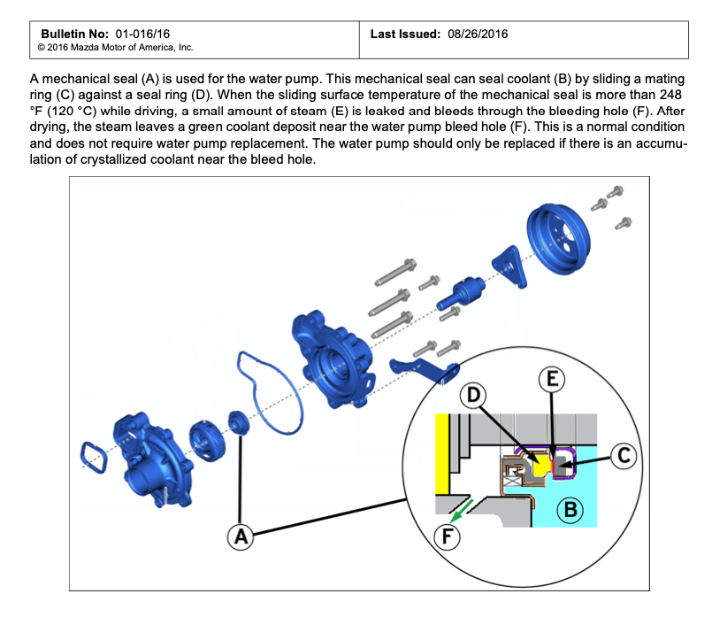

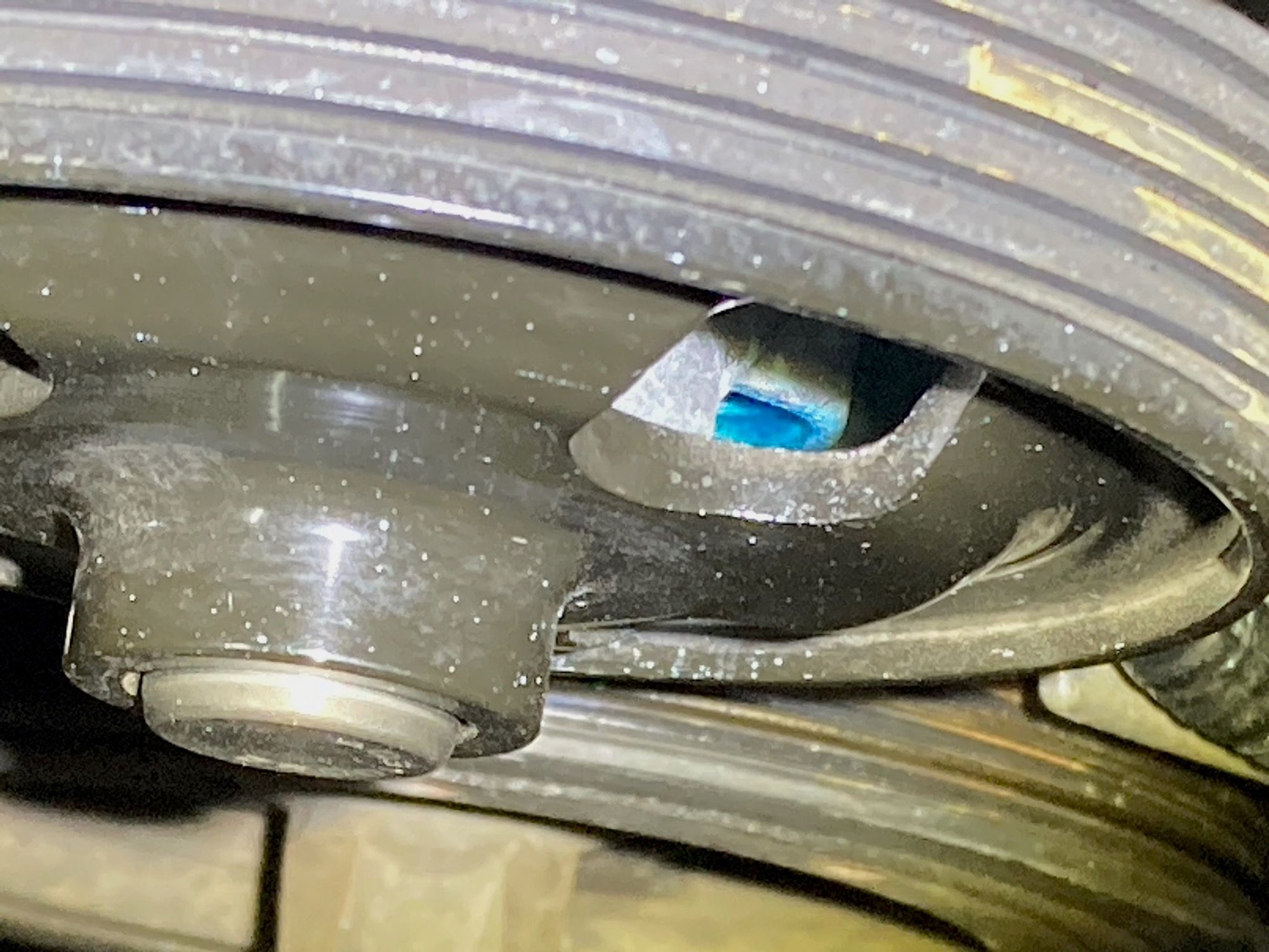

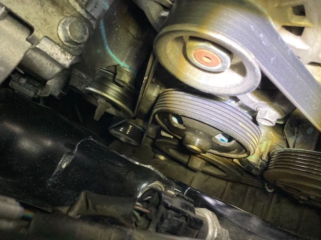

Unfortunately after that the water pump stated leaking again this time from the from the the front bleed hole and it sprays a line of coolant around
the area (as seen in the pictures) so they replaced it.
Then a few months later the Water pump was again leaking from the front bleed hole so they replaced it again.

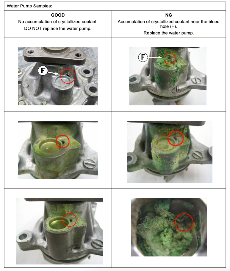

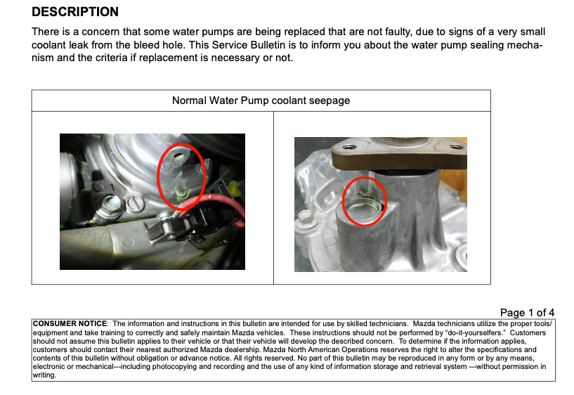

According to the service bulletin these pumps can put off a small amount of steam/coolant but not so much that it drips or would be considered leaking.
Our water pump is actually leaking not just putting off a small amount of steam as is noted in the service bulletin about this issue with these particular pumps.
So they Replaced it and literally after only a few months it again has started leaking form the front bleed hole.
It seem no matter what we do the water pump is leaking form its bleed hole and again it is not the small amount of steam as noted int eh service bulletin
it is actually leaking and fitting their description of a failing water pump.

Currently they have put Zerex Asian Blue Coolant in it and I have asked them to Put Actual Mazda FL22 Green Coolant back in there to see if that will change anything as the dealership said if not using factory coolant that "could" be an issue although not likely.

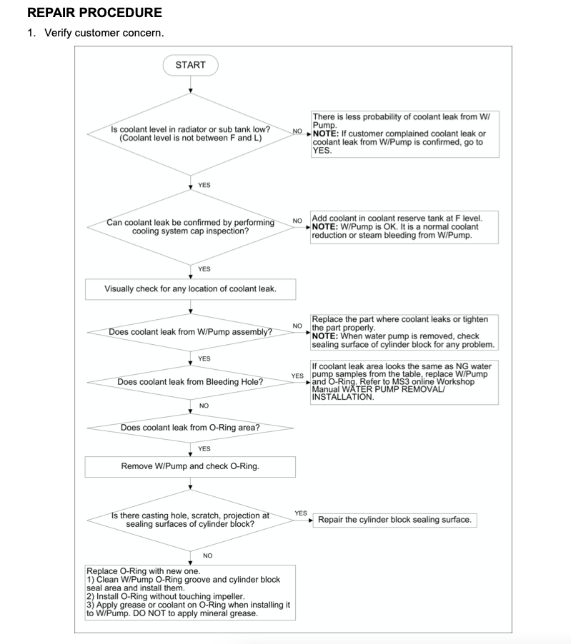

I'm attaching images as well as the images of the service bulletin description SB-10092584-6903
