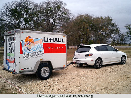

Glad you made it, fratedog. I assume you have an open trailer for your journey?
I have a 3 series with basically the same drivetrain and I can tell you that this...
... traveling from Pa to Tx was not a lot of fun.
