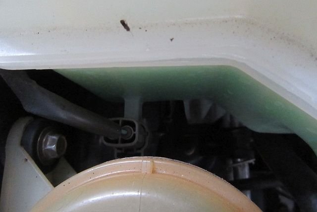

The coolant thing is the actual sensor , it can be replaced individually or a new bottle , one has to remove the bottle from the vehicle or if it annoys you just remove the electrical plug = no light at all .
