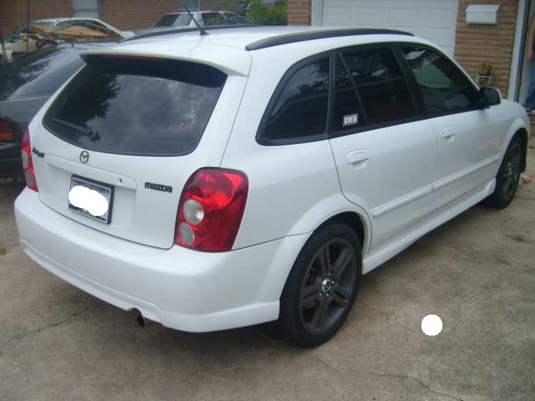

my wheel specs, btw, are 17x7 +50 offset. i could use another 10mm taken off of the offset at that width.
