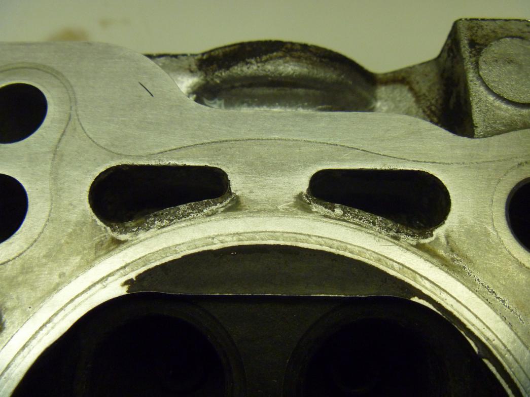

Default Is this head usable?
Well, I got the head off OK and am cleaning it up, but I'm wondering if it is usable. Please see attached pic. There is some corrosion around the edges of a few of the coolant passages. What do you think? Can I reuse this head as-is?
Old Dec 3, 2014 | 06:33 PM
  #29
hixx's Avatar
Joined: Aug 2007
Posts: 1,324
Likes: 1
I don't think i would use that head.
Old Dec 3, 2014 | 07:14 PM
  #30
147JK's Avatar
Joined: Sep 2014
Posts: 30
Should I have a machine shop resurface it? What's the typical cost to have that done?
