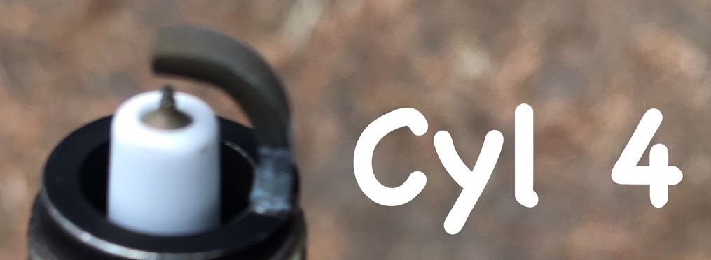

I have a 2000 Protégé LX 1.6L. I installed new NGK Platinum plugs (see photos) a couple weeks ago gapped by the vendor, and all new coil on plug coils and plug wires and boots.
No spark leaks detectable. The air filter is clean & white. I sprayed hoses with carb
cleaner checking for vacuum leaks. No change in engine sound. Engine idles almost normally but while idling there is an occasional faint “poof-poof” sound that seems to come from the air intake manifold that coincides with a slight slowing of rpms. After half-minute of driving at highway speed, the check engine light that is always on starts flashing. Codes are P0301 & P0302, but plugs 1 & 2 look good and plug 3 is carbon-fouled. Upon advice from this forum, I've added a gallon of acetone to a half-tank of gas to clean the injectors, which I haven't checked. Does anyone have an idea of what I should do next? I'm stumped. Thanks for any help!
