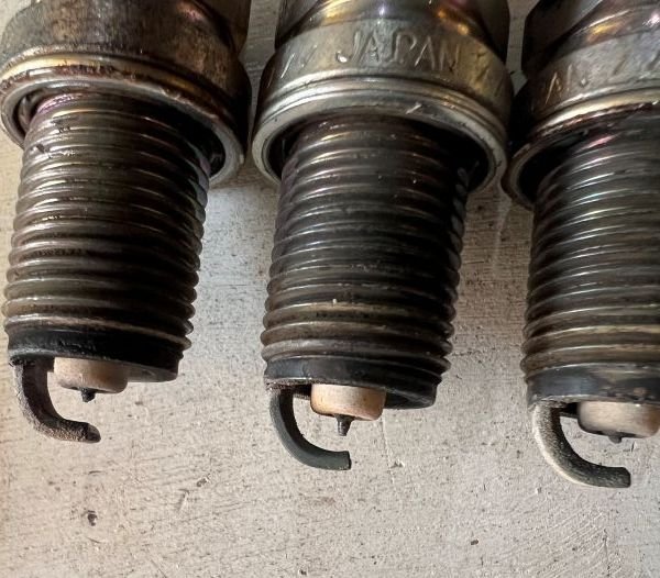

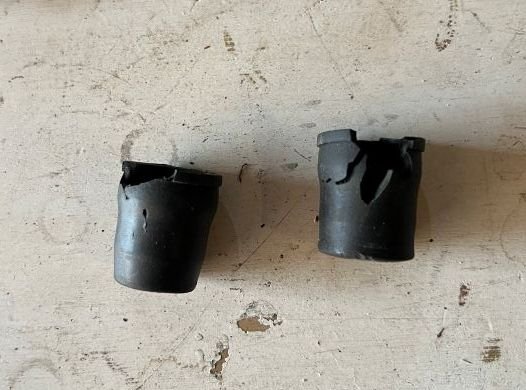

Got a P0302 misfire code after finishing some other work (battery replacement). Pulled the #2 plug and saw it was pretty bad. Pulled the #3 and saw it was even worse. To add insult to injury, when I pulled the plug cap off #3, the small "rubber" boot came off and stayed down in the hole. Took a bit to fish it out and tore in up in the process. <sigh>. so I decided to pull the others out and the rubber boot came off #1 and had to fish that out as well and tore in the process. So I ended up buying the kit to include all 4 of the plug "wires" and a set of plugs. Put everything back together and it runs great again. See pics below.

Well the next day it threw the P0302 code. I pull the coil and the plug and it looked really roasted. So I pull them all. When I pulled the coil wire off #3, the little boot on the end of the cap came off and stayed in the hole. I used a long pick to try and lift it out. It did not want to come out. I worked my way around it and it started tearing apart but I managed to get it out. So now I can remove the #3 plug. It was even worse. So I pulled the 2nd coil (on #4), pull the plug and it's just as bad as #2. The little boot on #1 also came off and stayed in the hole. After a bit more effort and swearing, I managed to get all of the pieces out. Pull the plug and it's equally bad.
Now, we've put about 40K on the car since buying it in 2017 from a local dealer (had 114K at the time).. He told me that the previous owner had the car recently serviced. I think not. Anyway, I put the new plugs (did check the gaps!) and new wires with the existing coils. Starts right up, runs smooth, no more "stutter". My son took it for a longer drive and reported it's running OK now.
So here are the plugs:
#1, #2, #3. Note 1 & 3 have almost no electrode left. (these are platinum plugs). I measure the gaps and #3 measured almost .070"!! #2&4 were around .050".
1, 2, 3, and 4. (in order). The ceramic bases look terrible as well.
The boots from #1 and 3#
So how many miles do you think those plugs have on them. I find it odd that #1&3 look the same but different from #2&4. I'm guessing the PO had the issue with the boots sticking and only replaced #2&4. What do you think?
