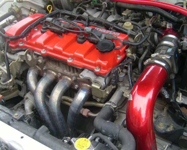

this is what an after market intake should look like. the little black box is the maf. you have to mount it inline with the intake. if you have any leaks, it will foul up the maf reading. if the wire inside of the maf gets damaged, you will need a new one. use only a direct replacement for your year model and don't try to frankenstein some parts together that don't go to your car.

my set up looks just like yours and the maf is in there but car wont run unless the maf is unplugged.......
