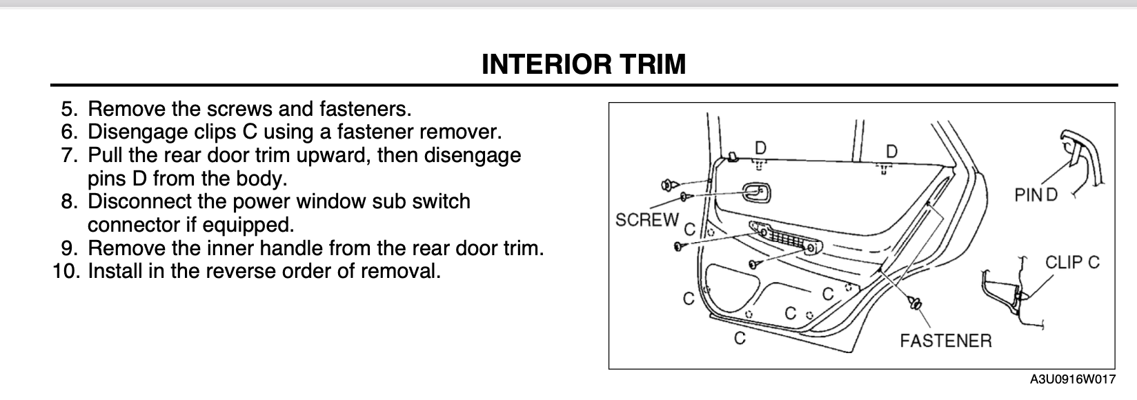

I was looking for clip D shown in the diagram below:
does anyone know the part number for these clips along the top of the inside door panel? My manual just refers to them as clip "D"

does anyone know the part # for clip "d" in the diagram below?

Go here:
https://www.realmazdaparts.com/v-200...trim-rear-door
