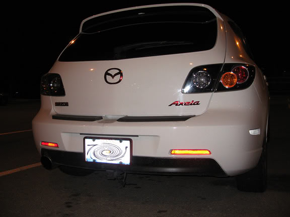

On the 3, the rear "winged" badge is pinned and partially taped. At least mine was.
For the licenceplate holes, I used clear epoxy, a sharp razor blade to trim it down and touch up paint. It looks OK, but not quite professional either. It's noticable from about 2-3 feet away, if the car is clean.

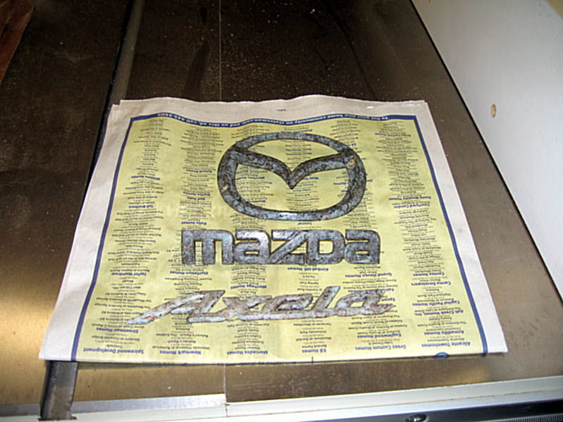

I'm taking the plunge and going all the way w/my badges this time. I'm tired of repainting all the time. It takes a full day of careful timing and planning, the night before prepping and at least one more full day to allow dry time.
No MORE!! That's my new motto. But I can't stand the idea of going back to the OE chrome look either.
After 4+ days of soaking in a bleach bath, these are what they look like w/ochrome.
I have since scraped some of residue of w/a sharp utility knife blade and washed them in Mineral Spirits and they look a bit better now.
I will soak them for a while longer in theammonia/hydrogen peroxide mixture to help remove any of the black copper residue, lightly sand w/1000 grit wet/dry, and we'll see after that.
If all this work doesn't keep them nice for at least the next two years, I WILL go back to the chrome. 'Course,I'll have to buy new in order to do that.

Well, to be honest w/you that's kind of up in the air right now.
The chrome is stripped as you can see. I had originally intended to paint them in a maroon/ruby red similar to what I had them before the chrome was gone. ButI've left the remains of the copper under layment in place instead of stripping that too, which givethemthe marbled look you see in the pic. Different, and I kinda' like it. I currently installed the two originalemblems that way. The Axela is a Chinese knock-off, obviously made of a different colored plasticand as you can see that came out differently.
