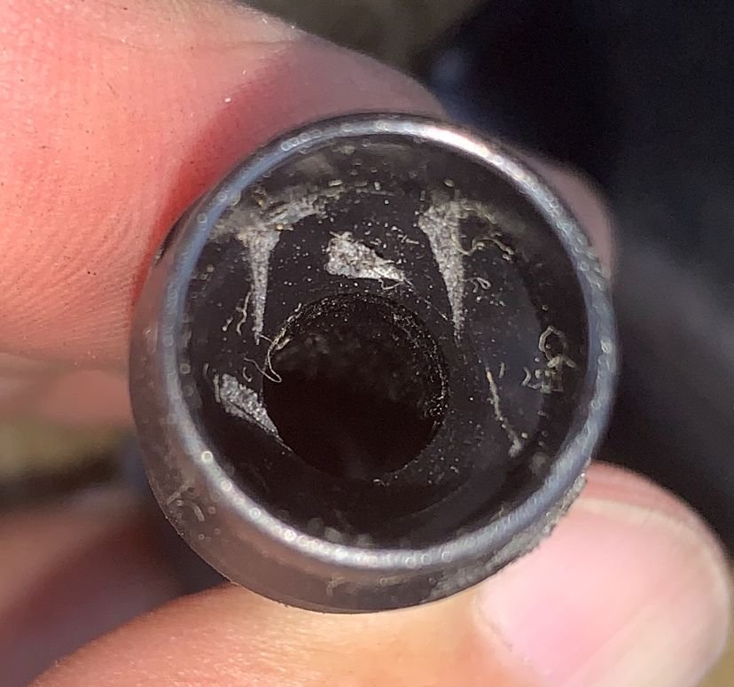

Ignition Coil Tube Casing 1 (Engine Left)

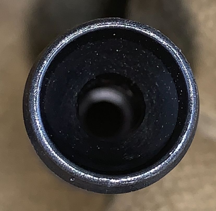

Ignition Coil Tube Casing 2 (Engine Right)
The Wires look fine. Ignition coils are about a year old. Only damage visible are some scratches on coil tube. They don’t look melted.
Both coil packs tested fine with an em.
Coils look brand new. Plug maybe?

Bummer. A problem with coils deep in the head is the tubes ark thru making a tiny pinhole for the spark to leak. You can find them with a little bit of enginuity but I see more coli failures than plugs. Saying that plugs are cheap and an easy fix if it's them.
