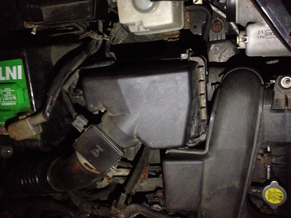

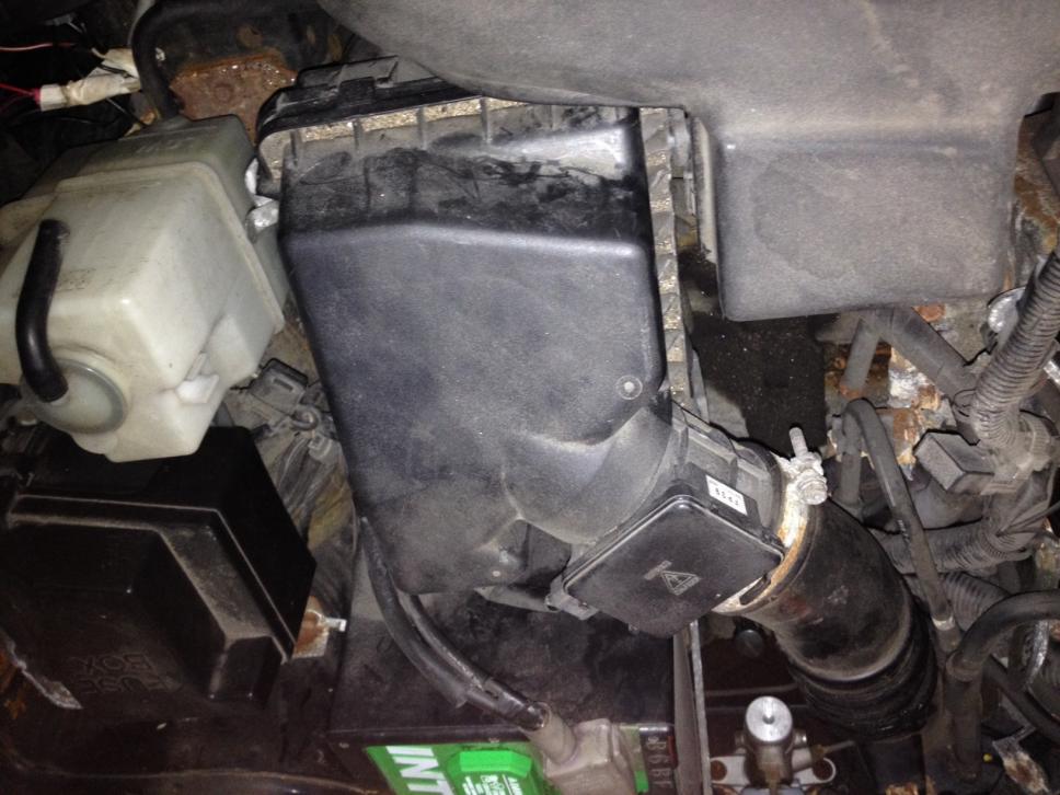

I recently purchased a 2000 Mazda Protege ES (1.8L) from a friend. I've been trying to replace the air filter since I bought the car. I've tried all of the major aftermarket brands to no avail. Finally, I ordered the OEM Air Filter from the Mazda Dealer.
No air filter I've purchased will fit in the airbox, including the OEM part. Any suggestions? Is it possible that the airbox itself is not original? I'm not quite sure how to proceed at this point, I certainly don't want to pay for someone to do this for me.

anyway you can snap a picture of the airbox

Thanks for responding. It's dark and freezing out so I took the best photos I could. Just noticed today that the taped up air intake hose was cracked. Plan on replacing tomorrow. Hoping there are no fitment issues come up there..

A good cleaning may help along with a quality air filter.
Thanks. I'll be trying that today when I replace the air intake hose. I figured the original Mazda part should be of good enough quality. This is the third filter I've tried, all of them won't allow the air box cover to seal over it but the old one slides in without a problem.

Some trimming won't hurt around edges.
