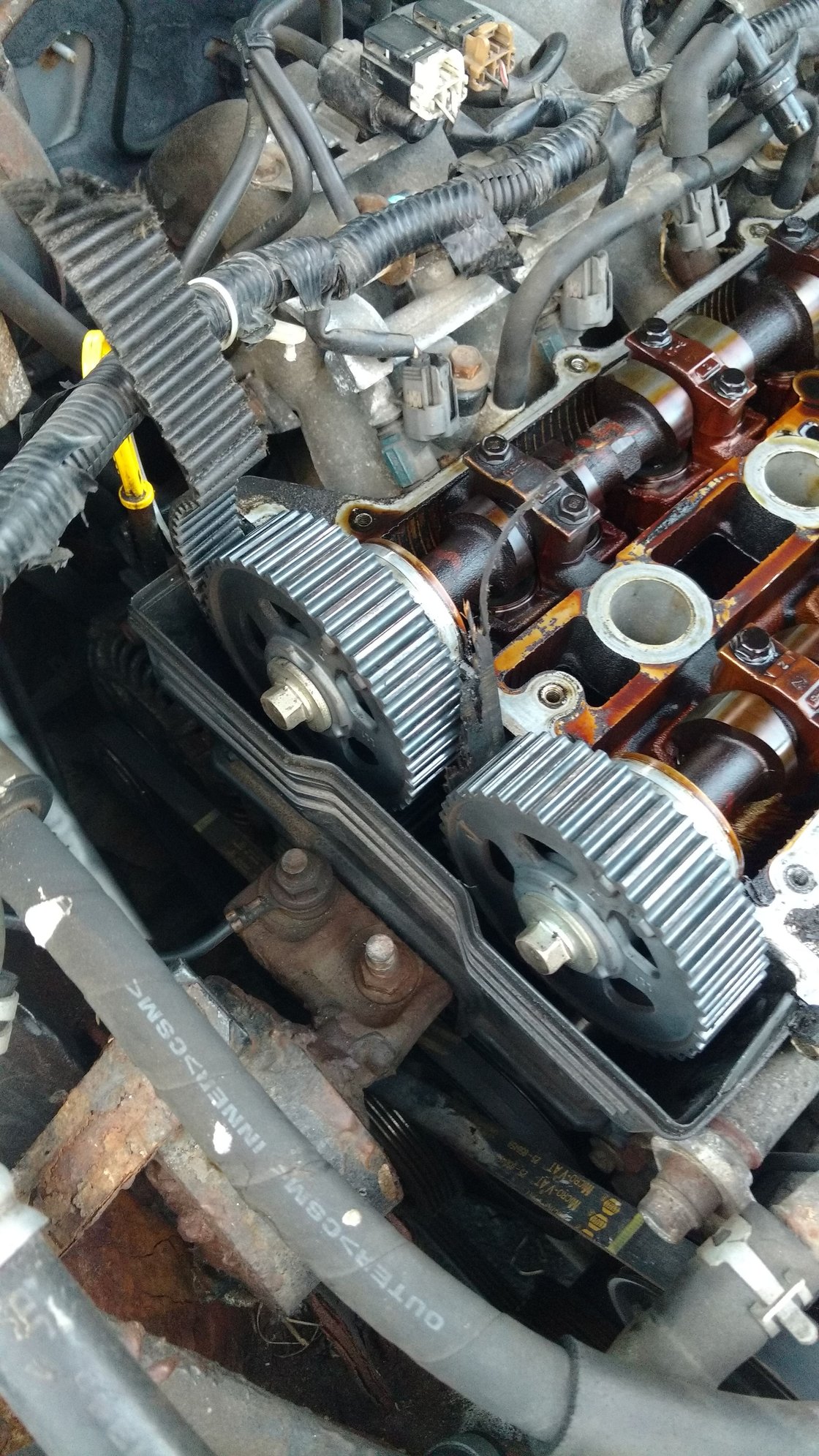

Update did compression test and got none.. took valve cover off and found this....Now need to do leak down test hopefully valves arent bent
Found my issue hope valves arent bent need to do leak down test

Wow sorry about your timing belt I think you have a non interference engine so it shouldn’t have effected anything

Well Im not too sure about that since I did a leak down test and 123 cylinders give almost same readings except the 4th I dont barely get anything ...So not sure if something is not sealing in there, I can hear noise from air intake and exhaust pipe. That apparently means leaky or bent valve. So I have to take it apart the broken belt was caused by something since belts dont just snap. The tensioner spring just got stretched on the end of it. So Im wondering it would be nice if I could get a old belt and try it but it might do more damage? Not sure.....

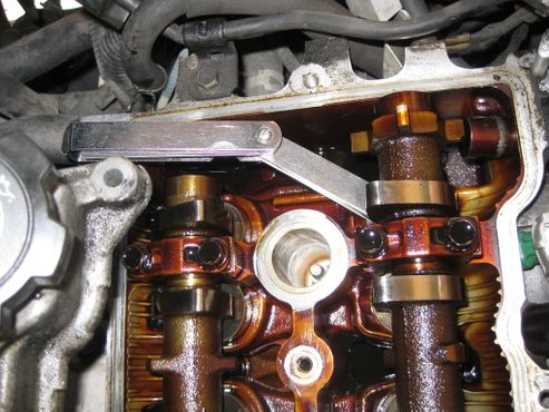

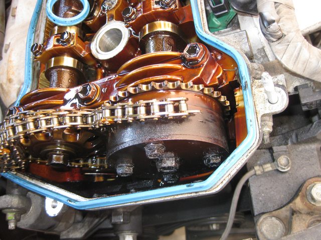

Sounds like it's toast. Before you remove the cams get a feeler gauge and check the valve clearance on all valves (write them down).
Due to an epic failure on my part, I snapped the cam chain in my Corolla. Of course, interference fit. #4 intake had .221" (no, I didn't misplace the decimal) clearance.

I did that, and I have 10th on all, so go figure. Ill check it again which I just did and yep all the same. I want to try to find a old belt and try it out before going further I saw a video on youtube and the guy says he always tries a belt 1st before tearing head off which I was thinking of before but was worried about doing further damage. But of course the problem is finding a used one and a new here is about 60$ and It has to be ordered. Thanks
