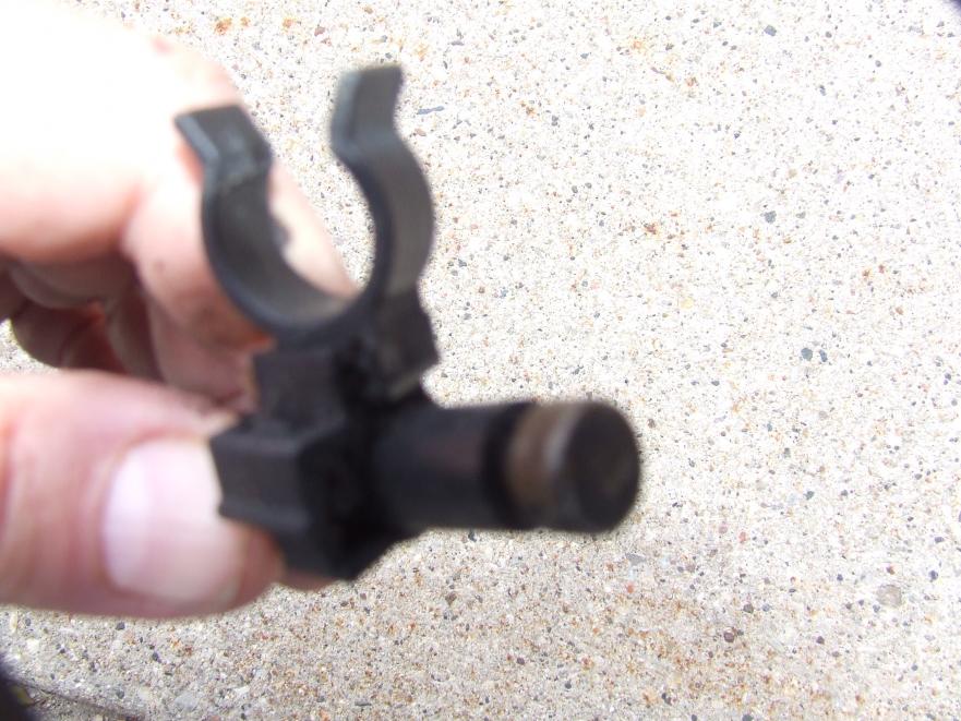

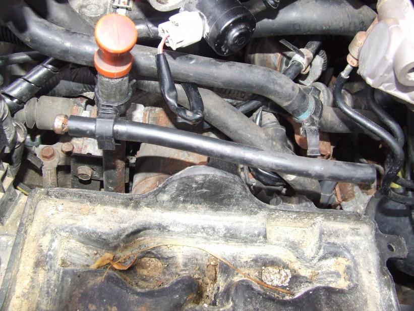

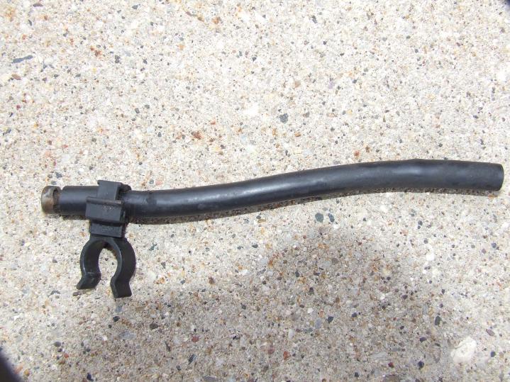

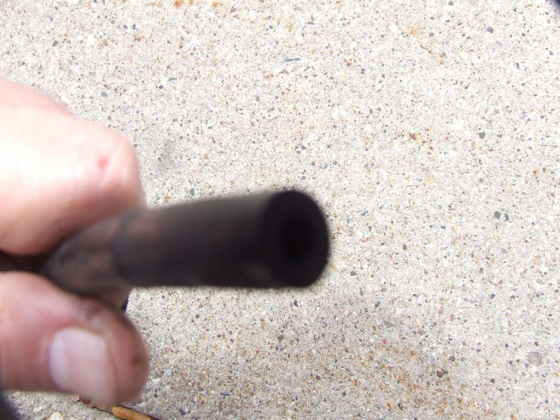

This is probably the EGR feedback tube Briansmobile mentioned in the beginning. Maybe the previous owner had trouble and tried to circumvent a proper fix.
There is another hose that had people scratch their heads before: it is a transmission vent hose. It should be like an upside down J with an open end that comes out of the transmission. Maybe automatic transmissions don't have that, but manuals do. In the protégé it is held in place at the battery box.

Here are some pictures of the hose I'm talking about. First pic is of it in by the battery box (where I originally saw it), the next pictures of of the hose out of the car.

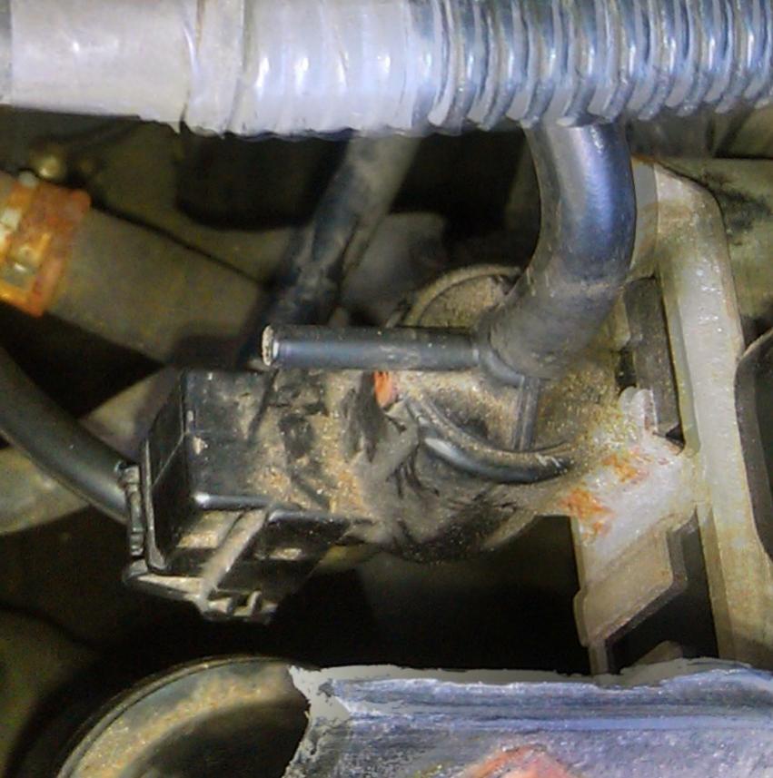

under the air filter box there are 2 small hose inputs in a "L" shape. I only have the bottom one attached to a hose, the top one didn't have anything going to it. The car chugged slightly when Idling so I went out when the engine was running and put my finger on the top of the "L" shape. The car stopped chugging when I did. So I changed the hose from the bottom to the top, and put a finger of the bottom one and the car remained the same. So I took this "hose to nowhere" and put it on that input line.
I know it doesn't go there but the engine runs better.
here's a picture of the "L" I'm talking about.

Could it be part of the evap system? The evap system must vent the hydrocarbon fumes into the intake somewhere. Check if your evap system is complete.
